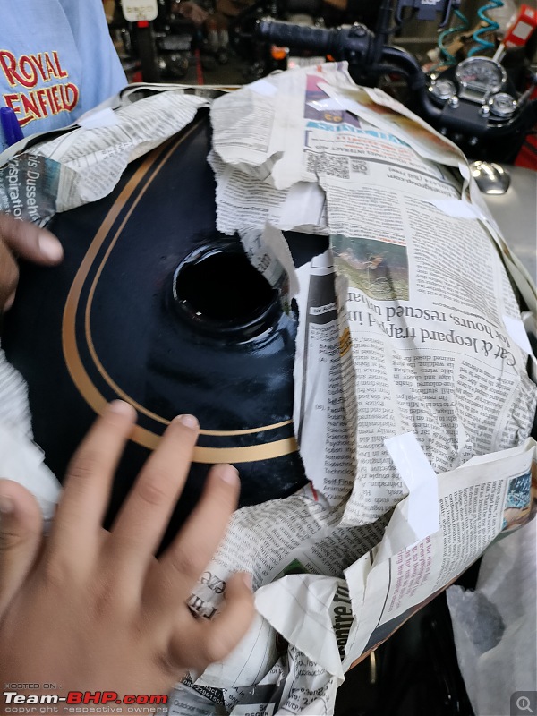

Here's my Bullet's tank painted and ready for applying the sticker. Lacquering is pending.
Mr. Syed applied the various stickers
