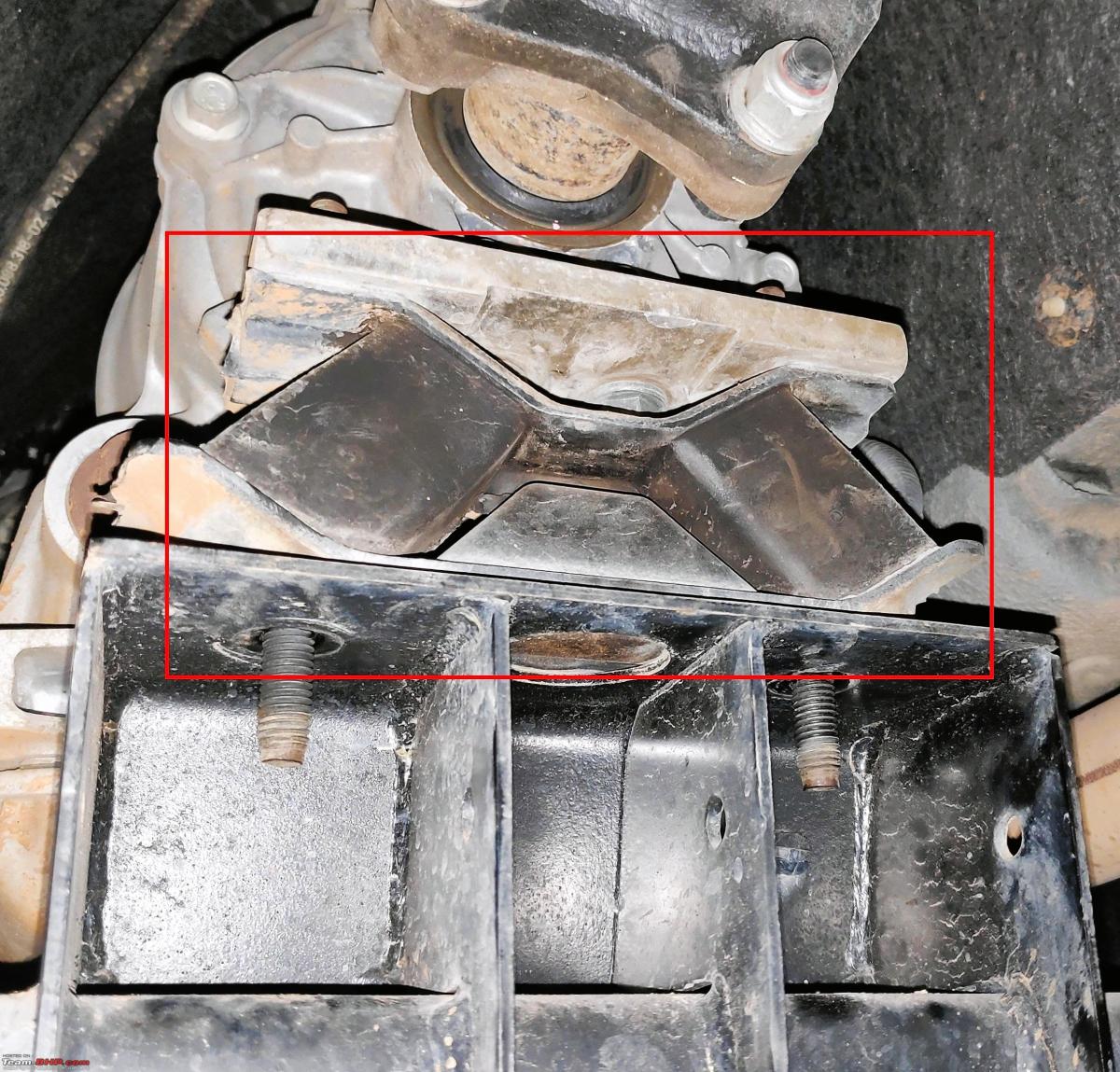

After that, they asked a senior technician to test-drive the car and diagnose the reason for coarseness. It was attributed to engine and gearbox mounts, which were to be replaced under warranty. The SA checked and found that the engine mounts were in stock but the one for the auto-box was to be ordered. Now this was a Saturday and their service center was filled with cars to max capacity. Nonetheless, they reverted within reasonable time and informed me that they could do the scheduled service but I will have to get the car back once the parts arrive. They also gave me an option of taking the car right then and getting it back once the parts arrive for warranty replacements as well as scheduled service in one go.

On 26 Mar 22, I reached SRT Coimbatore at about 1500 Hrs. I was warmly received and offered a cup of coffee. On enquiring about the car, the SA said that there was some delay as they had found alignment issue with one of the engine mounts. The technicians were removing and re-fitting it.
I went to their workshop and saw the car raised with technicians working near the engine area. I knew that I would not be getting the car before evening, despite the SA promising me delivery within an hour.
Now, as an outstation customer I could have pressurised them to finish the job asap and deliver me the car or I could have let them work at their own pace, accepting quality work at the expense of time. I choose the latter. I noted couple of the parts which were changed.
Engine mounts along with dampeners on both side.
Gearbox mount.

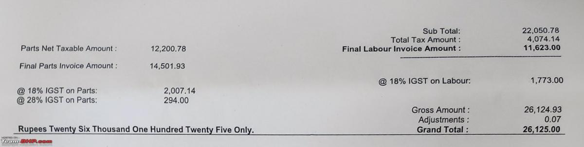

The total damage to wallet was as under: -
