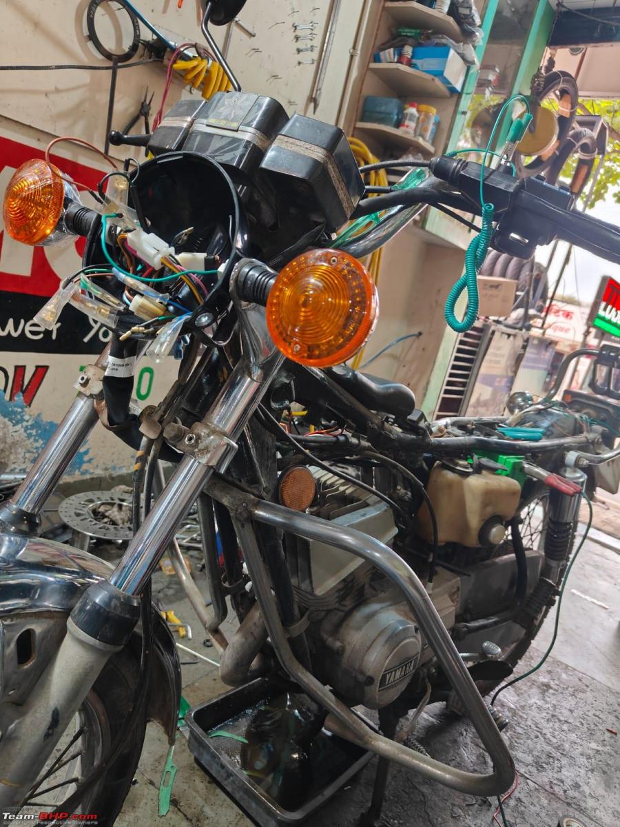

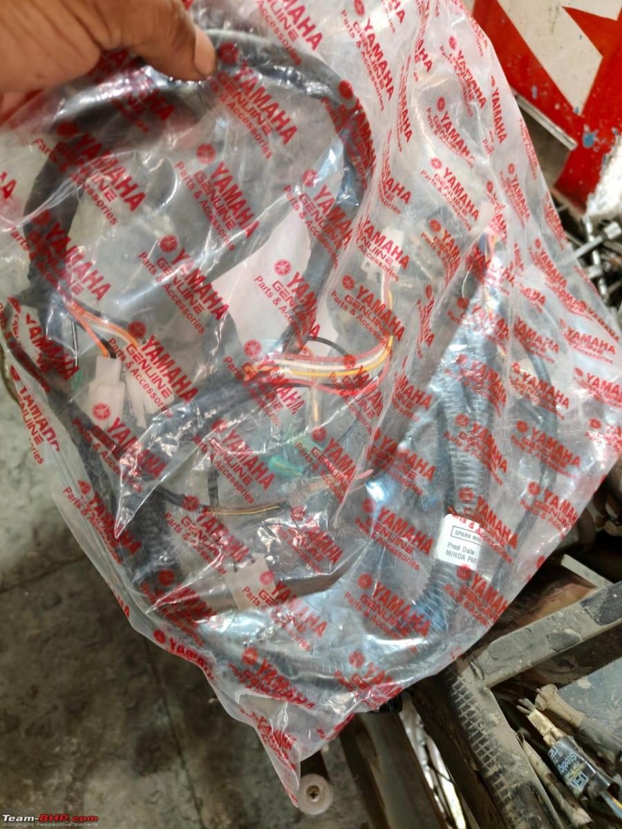

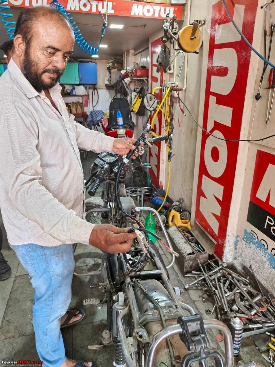

Wiring work in progress
Wiring loom

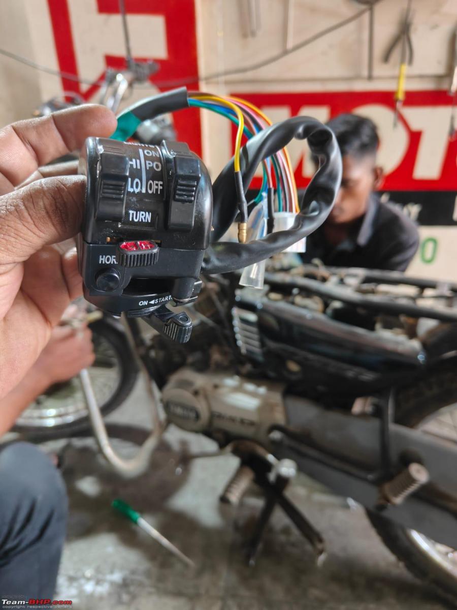

LH side switch. Stuck to the original design although there are other options available in the market.

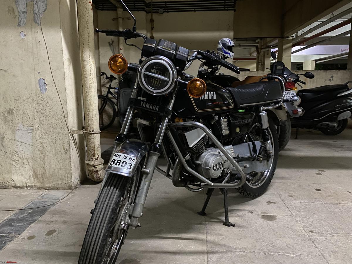

LED headlight, the DRL has two modes - normal is white, it turns orange when the front / rear brake is pressed
The headlight dome was also changed since the old was was cracked and faded

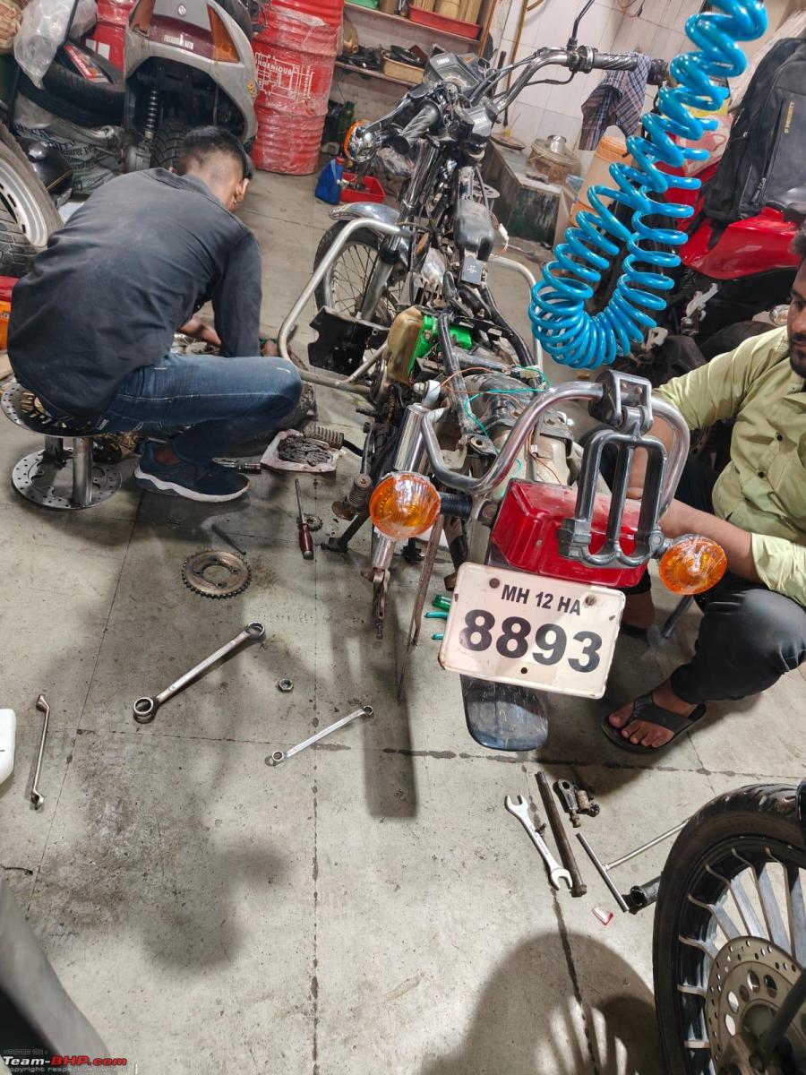

This is Anwar bhai, he's the main mechanic and has been working on my bikes since 2009.
OG showing off his new tech to the newbie!

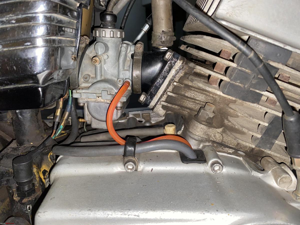

Intake manifold had developed cracks, got a new one. 2T oil pipe was also replaced.
The overflow pipes are missing, will get those added
