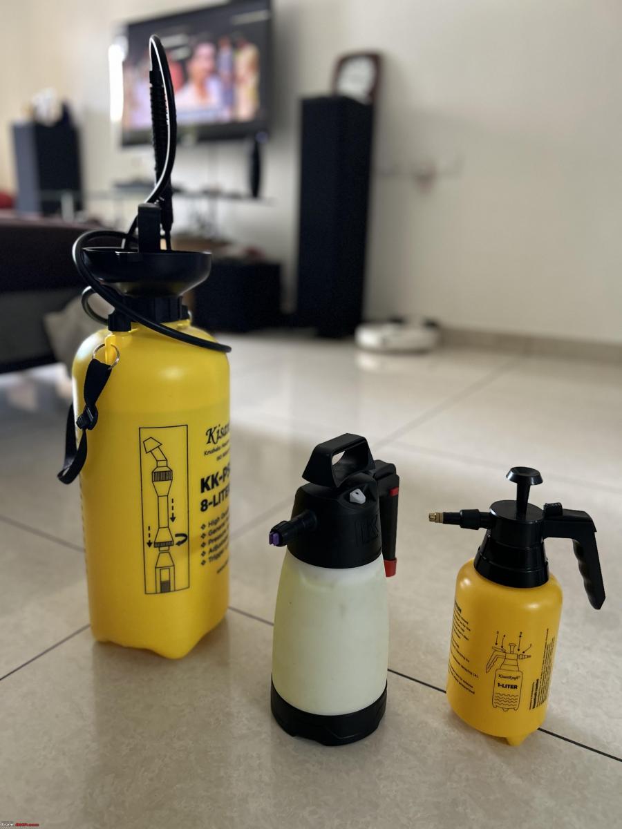

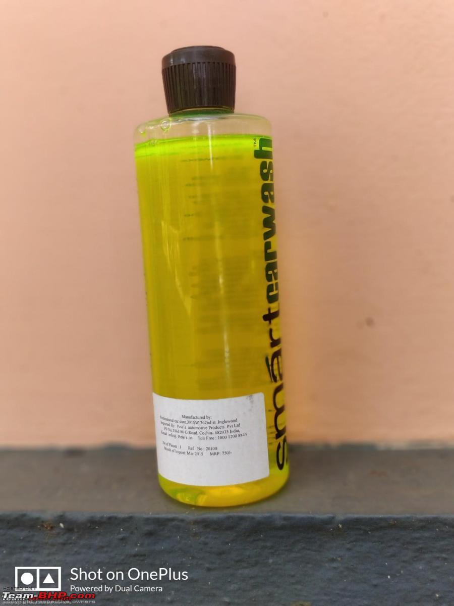

As first step, I decided to dump the apartment car cleaner guy and purchase few real essential items gradually, as and when I made more progress with this DIY car wash journey. This included some good quality TRC 600 GSM Microfiber towels from The Rag Company, 8L + 1L Kissan kraft water sprayers and a Turtle Wax Hybrid solutions Flex Wax, Turtle Wax All Wheel and Tyre cleaner, Tyre brushes etc. Everything was purchased from Amazon. From my self-washing experience over months, I have also created few templates with instructions for a quick wash, an intermediate wash, and a thorough wash during this learning phase. I apply these DIY methods depending on the condition of the car and also the energy and enthusiasm I have before starting a car washing.

  • Prepping (10 minutes): Filling the sprayers with water, mixing shampoo for wash, carrying MF towels, sprayers and muckets to the car: I used 10L of RO water, in both 8L and both 1L sprayers. Also, one bucket mixed with shampoo had 3-4L RO water. Other bucket was half filled with regular tap Cauvery water, used for soaking & rinsing the MF towels.

  • Pre-Rinsing and Soaking (5 minutes): Used both 1L sprayers to spray plain RO water on the exterior paint surface first
  • Shampoo wash (15 minutes): The 3 TRC MF towels soaked in shampoo was used interchangeably to wipe panel by panel, flipping the towel surface regularly and leaving it for soaking later. Used the next towel for the next panel and so on
  • Post wash Rinsing (10 minutes): Used plain RO water in the 8L sprayer from KissanKraft to rinse the complete car in 10+ minutes. I was surprised to see that 8L water was enough to rinse a car like Fortuner and I was even able to rinse the wheel arches, tyres also with it towards the end.

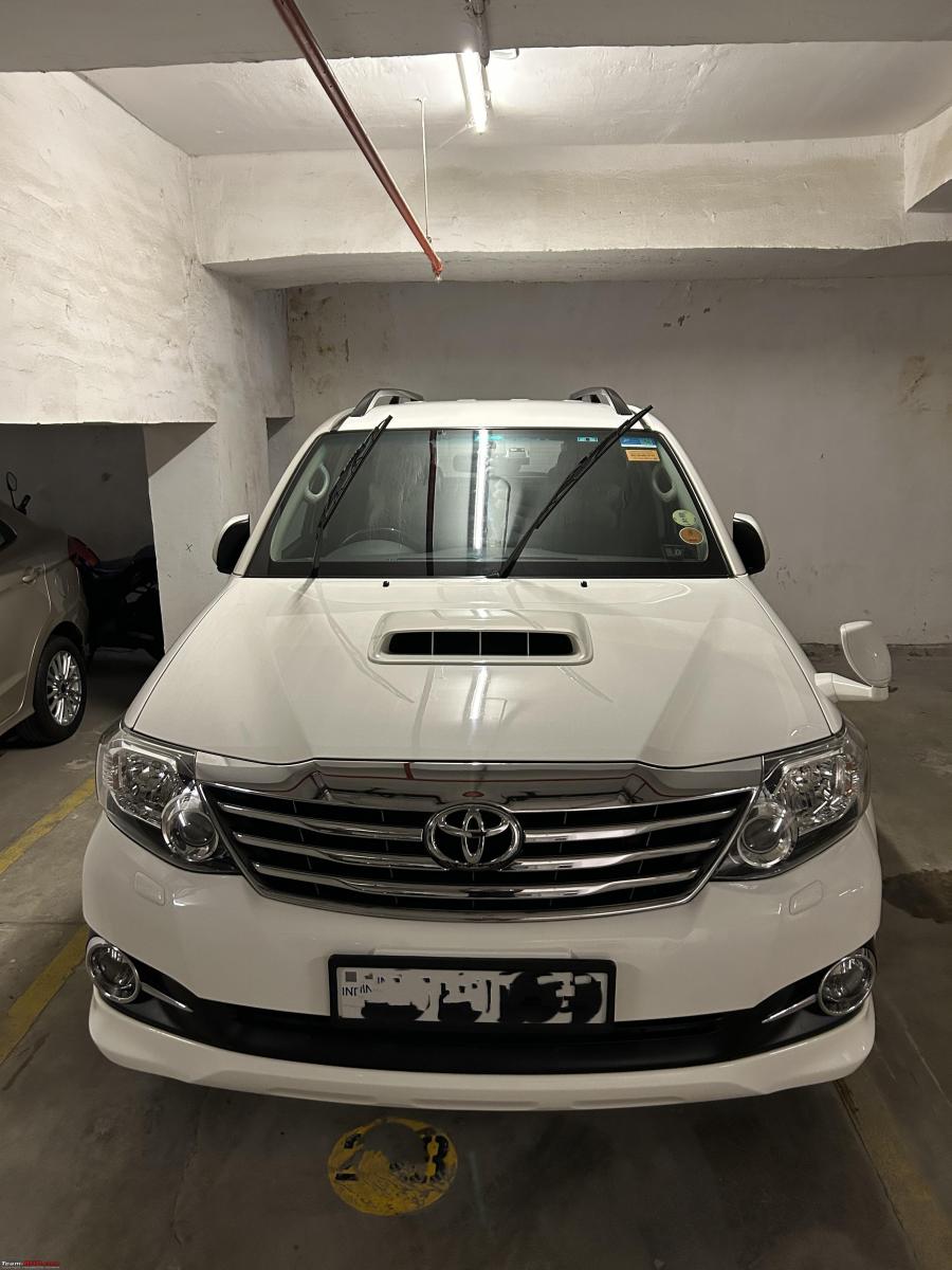

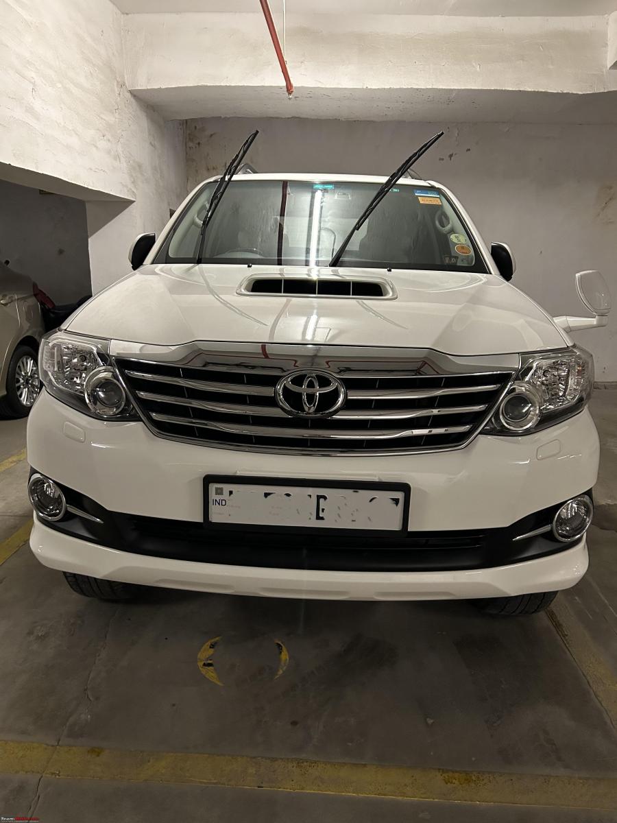

Sharing some pics of my effort from last weekend:
