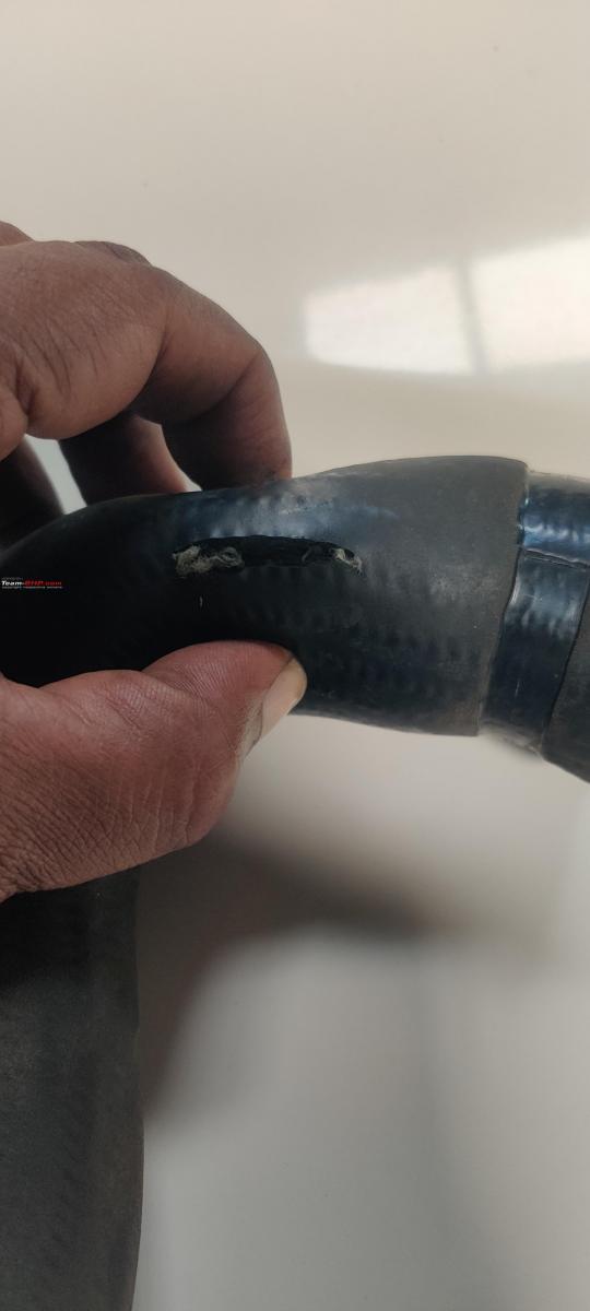

We were making good time when 30 km past Cuddapah while travelling at low triple figures, I heard a loud bang, the vehicle decelerated, and the check engine light came on. I was surprised as I had done the 60,000 km servicing just six days earlier.
I stopped the vehicle on the side of the road and called RSA. They were extremely courteous and arranged a tow truck, which took an hour and a half to arrive.
I drove the car up the ramp and to the flatbed, and both of us sat in the car, enjoying a commanding view of the surroundings on the way to the ASC at Cuddapah. We thought we might enjoy the situation as there was nothing else to do.
As it was a Sunday, they initially said they could look at it only on Monday, but with some persuasion, they took a look at it then. The intercooler to the turbo hose had blown.
After replacing it and clearing the error code, we managed to reach our destination that day and complete our trip.
The story doesn't end here. Two days after reaching home and 4,000 km later, on the way to work, the check engine light came on. There was a whistling sound when the revs went up. I drove slowly to my regular ASC. The clip fastening the intercooler hose had come loose. After securing it again and clearing the error code, it has been fine so far.
The intercooler hose had been replaced in Oct '21 as there was a recall. I am unsure if the intercooler hose has an intrinsic problem. I have decided to travel with some scotch tape for an emergency fix, as everything else is fine with the vehicle.
