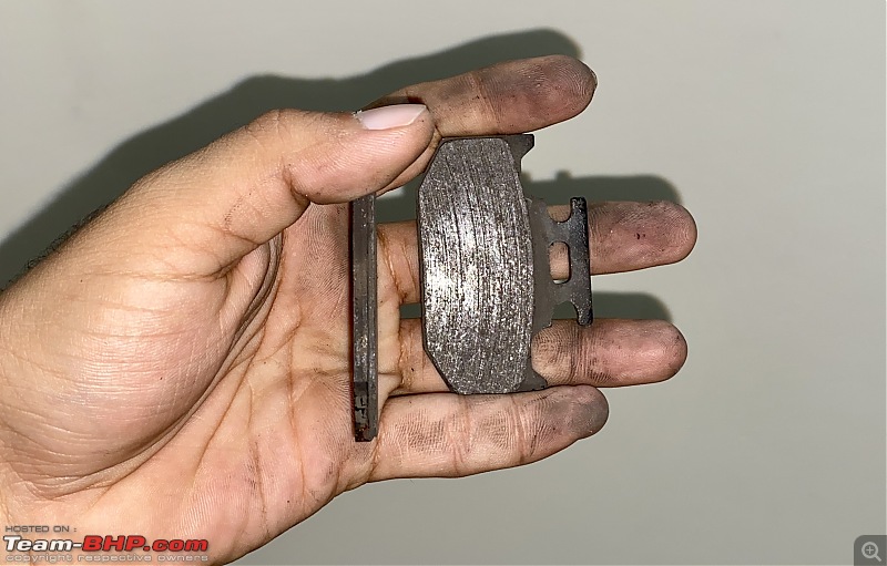

As he was performing the visual observations after a quick ride, he mentioned that the brake pads (front and rear) need to be replaced. I expected this to happen. During the 6th service, I asked them to install the Vesrah Ceramic brake pads. I wanted to experiment with how it would affect the braking performance, reliability, and effect on the brake discs. I found the answer!
As I mentioned before as well, performance-wise ceramic brake pads are way better than stock organic brake pads. But, every boon comes with a bane. Below are the disadvantages of using ceramic brake pads over stock brake pads (as per my experience):
  • Ceramic material eats the brake disc more as compared to organic brake pads. But, the salesperson from where I took these had said "Bro, this will not eat your brake disc".
  • In my case, this set of brake pads did not even last for 5000 km. In fact, after 3833 km, the front brake pads are completely gone while the rear brake pads could last for another ~500 km or so.But again, I cannot afford the time and money to get the rear sets replaced on separate occasions. Hence, gave the go-ahead to replace both the front and rear brake pads.
  • Considering the second point, spending ₹2600/- on front and rear brake pads is not worth it for every 3000-5000 km.
However, what surprised me was that the SA did not say anything about the brake disc. I expected that he would notice it and ask if they could replace it. But they are the experts, I did not ask as well. The estimate he gave came out to be around ₹7400/- (more on this later below). I asked the SA to return the brake pads. Usually, I do not do this, but since it was ceramic brake pads, I was curious to see what it looked like after complete wear. Then I dropped my bike and took a Rapido and Metro to reach my home. I said that I would come to pick up the vehicle today (16-Jun-2024).And yes, they do work on Sundays between 9 am and 1 pm.

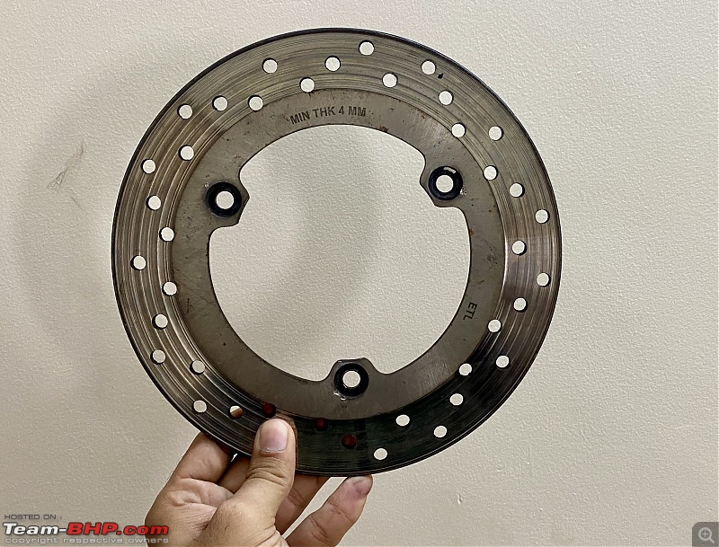

The day I dropped the bike for service, I got a call from a close Senior Mechanic saying that the rear disc will have to be replaced as it has worn out completely. Aah, the culprit is the ceramic brake pad eating the metal disc! Without batting an eye, I told them to proceed. Why? As per my knowledge of physics, a thin metal is more susceptible to various stresses, leading to failure when compared to the same metal of higher thickness. After all, it is a wear and tear component that will require a replacement one day or the other, so why risk safety to save some rupees?

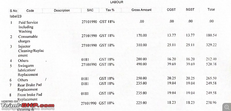

At least for me, I found this to be useful. And, the AMC became active from this service itself. Below is the breakup of parts and labor for this 7th service:
Summing up l the above (including the AMC), it cost me ₹8312/- in total. considering the perks of AMC, I am fine for another one year and R15 will clock more kilometers in the coming days. So, this should be a good deal for me.
Along with the returned brake pads, I also got the rear brake disc along with the 3 nuts holding the disc to the wheels:
And, after the new rear brake disc installation, this is how it looked fresh after I took the delivery today:
If you carefully look at the right edge of the disc (yellow arrow), it shows the wear limit (not sure if it can be figured out in the above image). Once the shiny part of the disc is worn out, it is an indication that it needs to be replaced.
