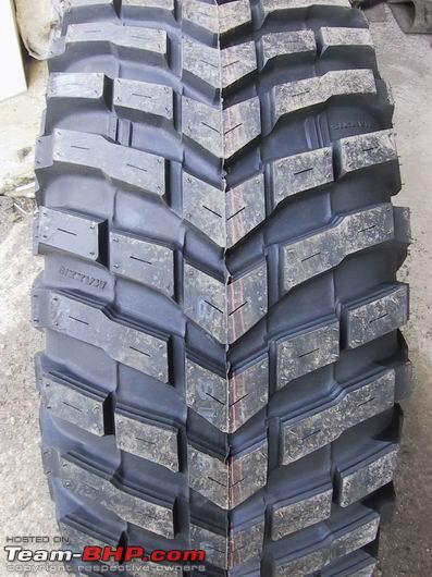

Maxxis Mudzilla:
Attachment 42347

Shanavaz, If you want outright TRaction, you could go for the max mudzillas, they appear superior to me than the geolanders. But you will have road noise like a truck!
The geolanders are fair, but the Maxxis Mudzilla is great and you should have one real capable vehicle in Slush!
The Geos may be good on sand, but on slush, once the sipes are blocked, you have a racing slick tyre!

The suggestion to have a set just for off roading is a good one. Then your first pick has the superior tread design, I think, Maxxis. If you go with a compromise tyre, all terrain, then I would say the BFGoodrich is adequate but not great.
