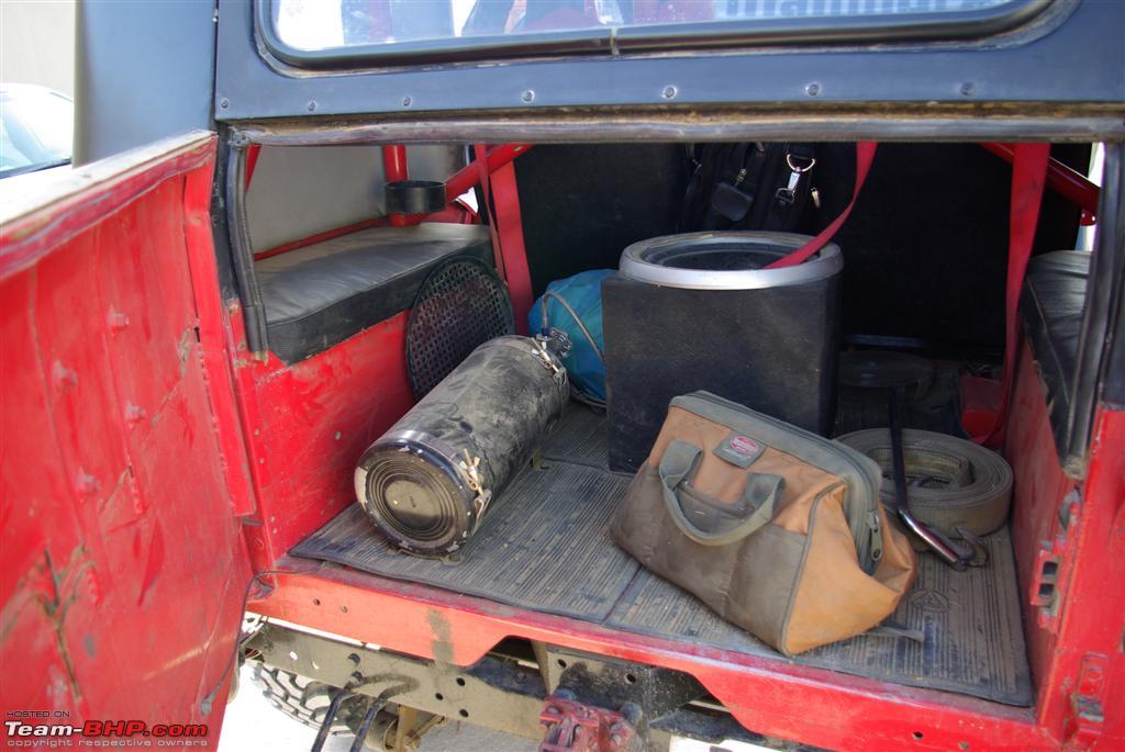

Nitrous
Hey GTO,
You had asked me about the power output of this motor. I really do not know for a fact since it has not been tested on a dyno. My seat of the pants guess is that it is at least 150 hp. Torque is in the range of 300 + ft lb.
These estimates are of course with the use of nitrous. Oh yeah, I dropped a +50hp dry nitrous system in earlier this year and forgot to add to the list of modifications on my original post. I know you guys probably think I am joking so attached are some pics to show the nitrous injection into the intake manifold and the N2O tank in back of the vehicle. The N2O tank is the anonymous black color gas cylinder next to the subwoofer box. There is a system arming switch on the dash and a microswitch that triggers under full throttle.
Sometimes I think this project will never end.
