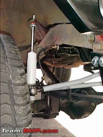

Spitfire, There is not much complexity in the SPOA for a Gypsy. That's what I have gathered after reading/researching a lot about SPOA for Samurai. In India people have not got it done hence not many examples of SPOA and not many mechanics who can do justice to it.
In my opinion, the critical aspect is the ability of the mechanic to pull it off. I have full confidence in the parts that we would have to fabricate for the SPOA. The advantage that we have abroad is that the complete kit would be available off the shelf and here in India we will have to go to several places to get it done.
This is what would be required for the SPOA:
  • Front wraparound spring pads
  • Rear wraparound spring pads
  • 2- 7" longer front brake lines
  • 1- 7" Rear brake line extension
  • Front and rear driveshaft extensions
  • Front and rear long travel shock mounting
  • Front and rear HD Ubolt plates
  • Front and rear custom Ubolts.
  • Custom height Zlink steering linkage
Also here are some visuals of some critical parts of SPOA. I am sure our mechanics are competent enough to pull this this off.
However, having said that; I am yet to find a mechanic that is willing to take up this project for my Gypsy
Have contacted Psycho for this. Let's see if he is willing to take this up.

@Shahnawaz: Thanks for the info. Really appreciate it. I have been doing research on my own too but i guess with what you have outlined above my search has become much easier.
Actually i was also of the same opinion that SPOA for the Gypsy would not be too difficult. We will need to engineer this well. With these parts being the main load bearing components for the whole vehicle i was not too sure about getting them fabricated locally(Goa), Bangalore maybe a different scene.
Has anyone you know tried to import these? There are a few available on ebay.
Wonder why any garage will not want to do this mod. I have a garage(partly owned) back home. I can try this if i have the right parts available.
Hoping Psycho agree

Spitfire, Man.. you have a garage and yet not going for SPOA it . If I had that luxury, I would have done it -- many times over.
I have lots of reading material on SPOA for a Gypsy with detailed instructions etc for getting it done. I know that there are SPOA kits available from $500 onwards in US. The challenge is how to get these here.
Let me know if you need the reading material and I will zip it and send it across to you by email.
