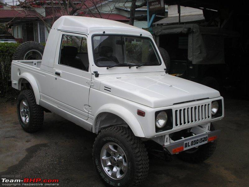

Its possible, Gypsy has a divorced transfer case
it has a 75 bhp nissan cd20 engine witj 14 kgm torque. with 4x4 working.
Note from mod: Use Team-bhp to upload photographs, externally hosted pictures are not allowed.

Is this white gypsy yours,rajan?
ML is Meghalaya state?
no, it belongs to a friend's friend in Meghalaya.
Boy, he sure needs wider rubber to make that lift job look good.
