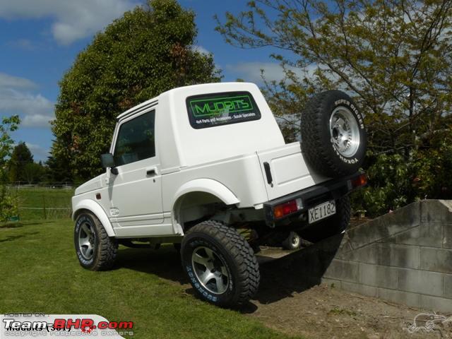

Just saw this thread.. and there is a similar looking sammy here,of one of the 4wd shop guys.Thought I will share. Its the factory coil spring model, this one is lifted though. 30 mm suspension lift with King springs and 50mm body lift. Note the 1.6 16v. And the hard top is fabricated fibre glass body.
Motocoorg is offline
Old 20th February 2009, 13:32   #89
khan_sultan's Avatar
Join Date: Apr 2006
Location: Noida/Bangalore
Posts: 4,944
Thanked: 6,469 Times
Hey motocoorg, in 4th pic, the leafsprings are visible -- both front & back. Though in fist pic, one can see coil springs in the back.
Wondering how the 'coil' springs are working here. Any idea? Would love to know more.

leaf springs?
Khan bhai,
It is not leaf spring out there. They are trailing arms which locate the axle in position.
