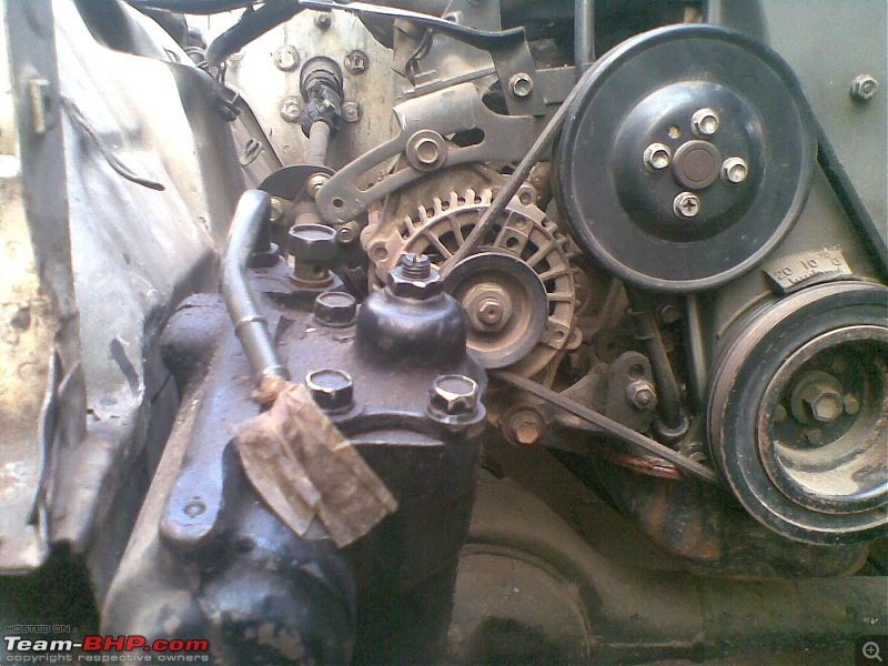

-Power steering box was installed.
-Custom 4 core copper radiator is getting installed.

Got few pictures of the radiator & engine bay showing P.S box (courtesy to Ashwin-ashwar87)

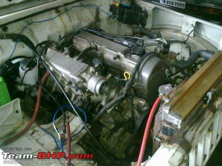

Engine bay in its final shape.
Its a bit congested.
Brake booster & Radiator are in position.
Powersteering & AC piping need to be done
Finally after a year, Your Gypsy is getting ready.
Good to see this.
Please finish the work and bring her on road and post pic's.

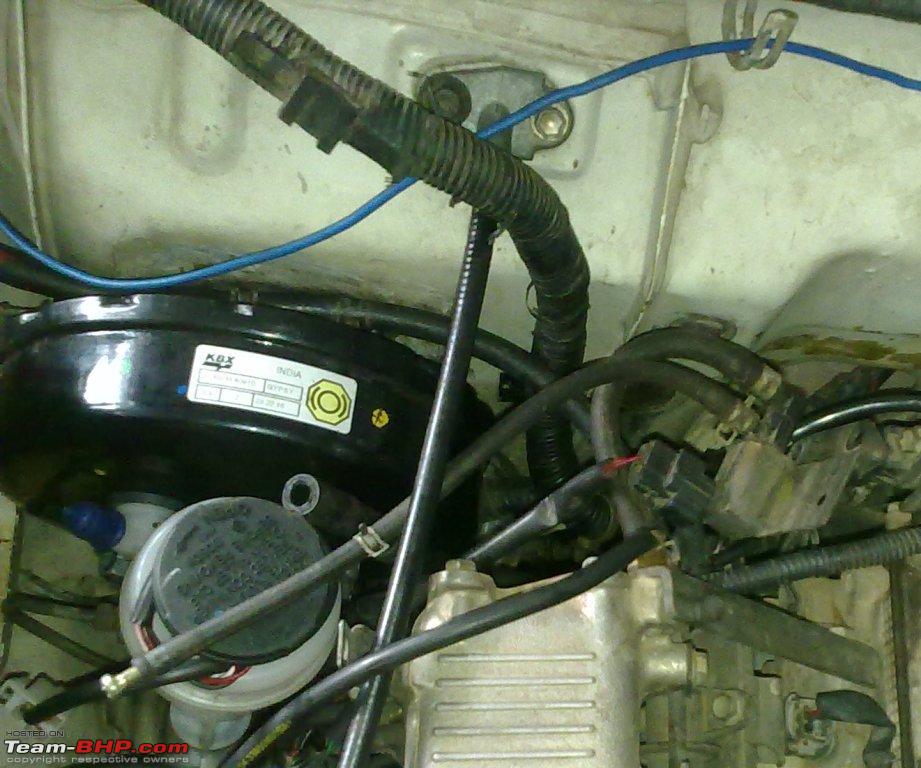

Which break booster and how much did it cost?

Its Gypsy King MPFI's booster. (4.5k INR)
Maruti Zen's booster is also an alternative
Ashvar87 got a similar set up in his 5 speed 410.
Its more than a year in recession era.
