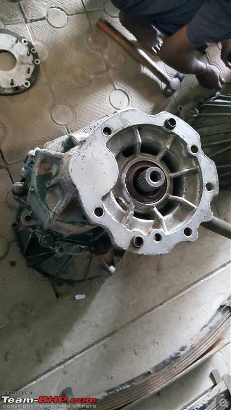

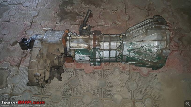

Can anyone help me identify this Mahindra Gearbox and what type of transfer case attaches to it?

Could that be the 4x4 version of the BA-10, as used in pre-NGT 4x4 Armada/Bolero/Scorpios? If so I'm assuming it would take the Borg Warner TC; the splines and mounting pattern look strangely familiar (I've got the Armada Borg Warner in the Marshal)...

Actually discovered it's an NGT530R

That is indeed a NGT530R. The bell housing is large and meant to mate to the mHawk, with the slave cylinder inside it.
The New NGT530, that comes in the That, the bolero storm and the Xylo (all there with the 2.5L engine) shares the from part of the gearbox housing with the 530R. The real housing is different.
The older 530 was a close cousin of the BA10 - came with the 2.6L CRDe engine..
