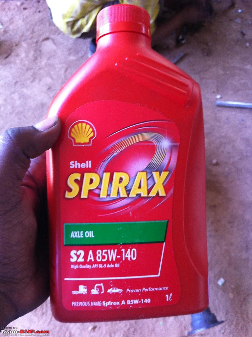

Well, I was so keen of getting a locker, but, somehow, I also thought I needed to own an LSD. Because, I can always get a locker for the back, and put this LSD in the front.. So, started the traction improvement mods with the LSD!
And did you check if the LSD works, works properly?
Well, sort of.. And, here's where I need the assistance experts like you and others!
What I discussed with Sreejesh and did was:
  • I jacked up one wheel, and tried to turn it with hand/force. Its like the brake is jammed and the Jeep rocks forward.
  • I jacked up one wheel and slowly let the clutch go in 2WD, 1st H, and the Jeep jumped from the jack.
  • Jacked up both wheels and tried to turn one wheel, the other wheel turns in the same direction. However, when my mech was turning one wheel and the other was rotating, I tired to stop one wheel, and with my hand it was very difficult..
So, is it working fine? Dear pratheesh and fellow bhp'ns please suggest some more tests for me to make sure my LSD is working fine.. Just for the peace of mind that the money spent is worth it!
Now, for the 2nd quirey. The oil I used is this: Is it fine?
Seems to be in range, so must work fine.

Why not use 90 instead of a multigrade, even though it is in the range?
I use MAC Spirol 90.
