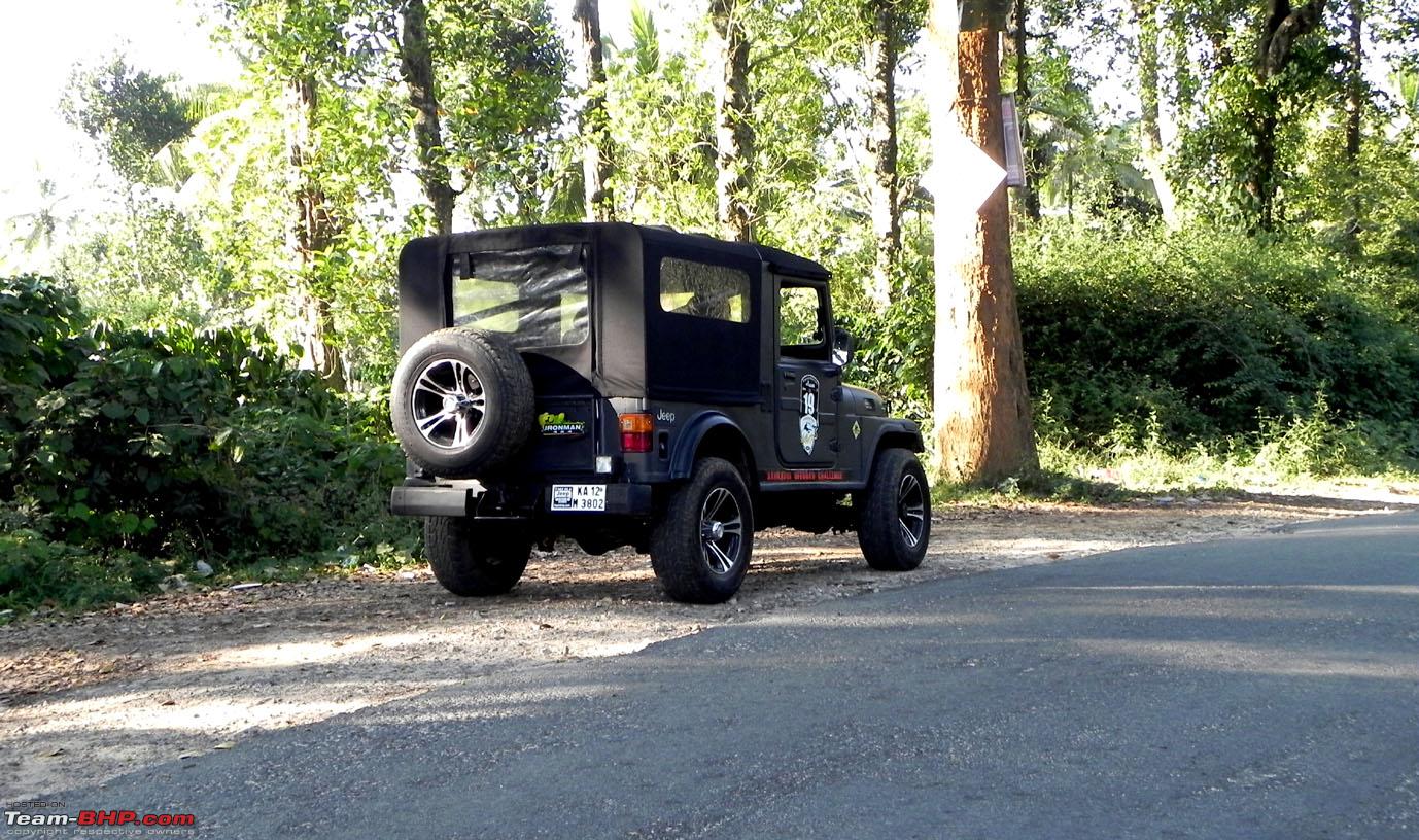

Its a break from OTR's now. So, the soft top is ON! Got the original Thar CRDe canopy, which fits like a glove!
dhanushs is offline   (1) Thanks

The drawbacks i find for my purpose would be the soft top , and the fuel efficiency. I ve heard that that jeeps are quite heavy and hence poor FE.
I ve been using indica (sold recently) as a work horse . The somersault seats is a big advantage to me .
Primarily it was used as a car to transport machines and a small car for city run arounds.
A hard top jeep will be a good option , again it will lack comfort and FE compared to an indica.

Dhanush sir already done the replica of NC paint proposal for the commander. Cant believe the cost difference is so high compared to others variants but then again you happened to point of the ingredients to make it good. Only advice dealer told me was to wait for a couple of hours for it to dry and then do the matt clear. Is there anything else that is required apart from NC base and matt clear? Painting starts on monday.

The jeep looks really swell! Especially with that soft top really completes the vehicle.
Thanks ninjatalli !!..
Just one suggestion - lose most of the stickers if possible (even a few of the tbhp stickers too if possible ) the matt finish will look perfect IMO.
I was thinking about removing the stickers on the door and below. But, it was stuck when I went to a OTR just after painting, so, dont know what will be underneath!..
P.s. we need a good set of pictures - kind of a portfolio, don't you think
Thanks!
Will do Sire!
Now your Jeep looks really good. The canopy fitment is one of the best I have seen (when done outside).
Still, I see wrinkles on the rear bow and A pillar area, get that also sorted. Did you use the plastic press fit type plugs near the A pillar channel? Any rattling?
BTW, how much did it cost?
