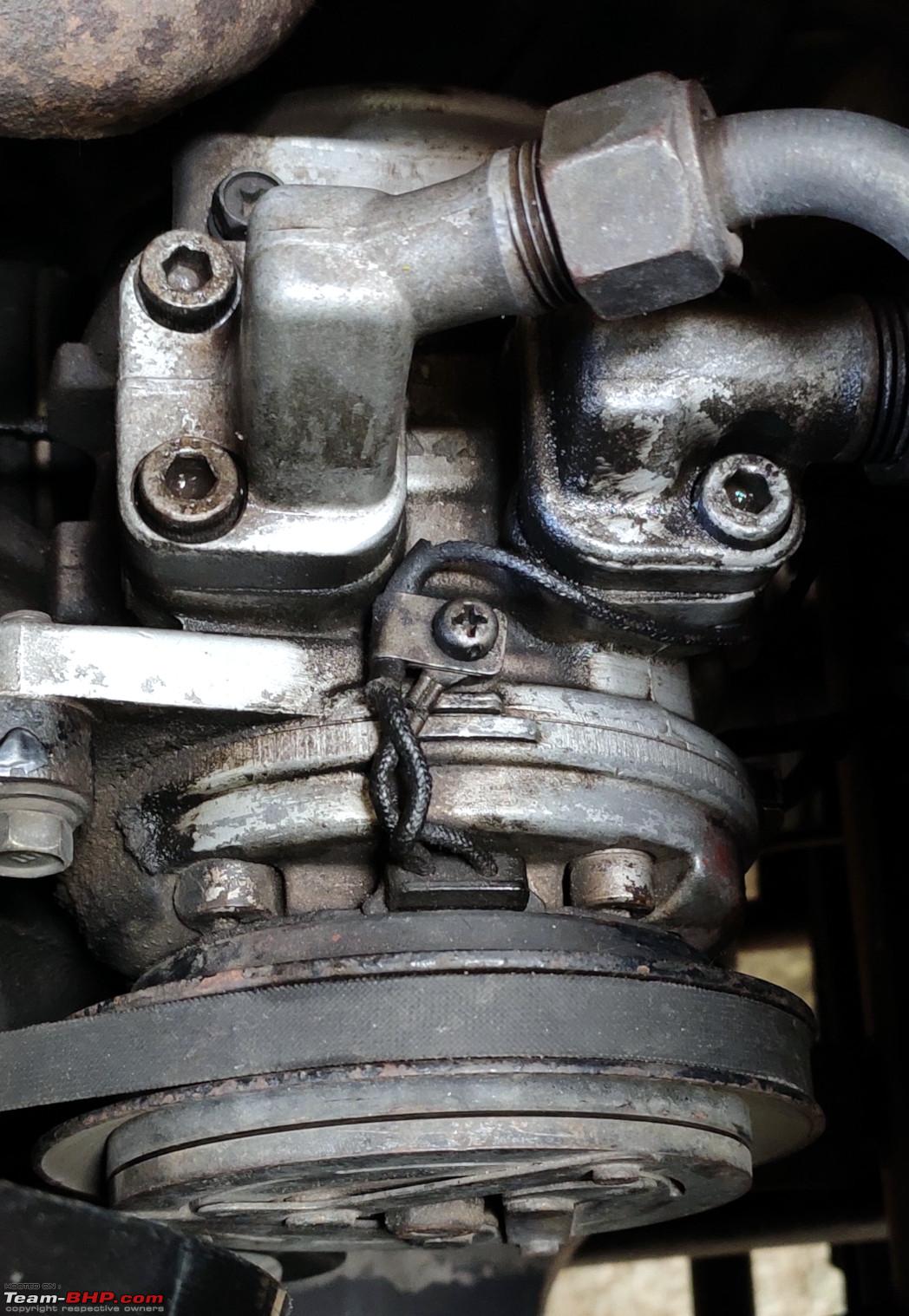

In addition to all the other advice check whether it is a factory fitted AC or not. It did come with a factory fitted AC, but those were not common.

Reason for the emphasis on factory fitted AC - if a Gypsy is used the way a Gypsy can (and sometimes should) be used the mechanic fitted ones will give trouble. Esp mounting brackets cracking. Leading to other problems.
