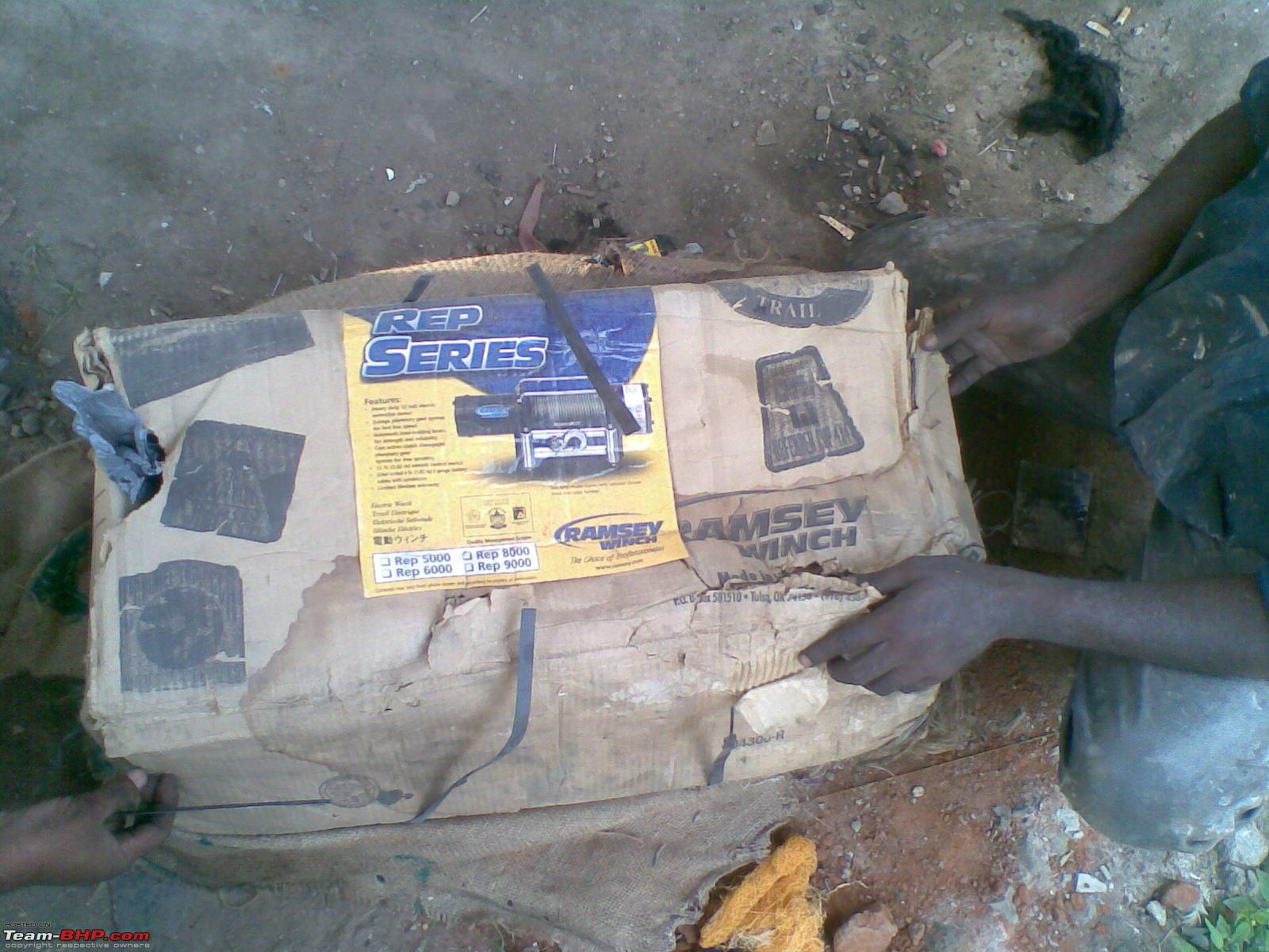

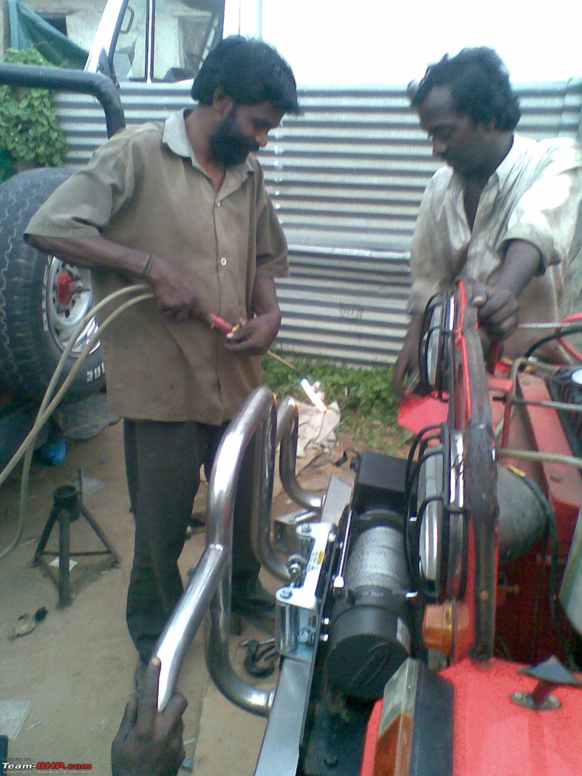

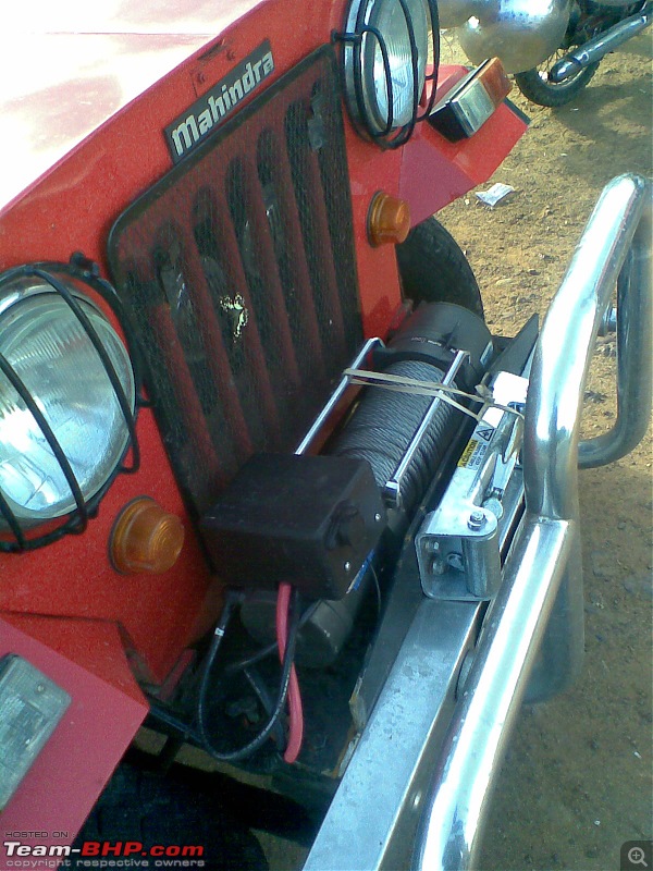

My Explorer is again on the spot light, its been months since I visited my thread here.
Finally my jeep is now wearing a important self recovery equipment that is Ramsey REP 8000 winch. I got this winch from Vinay of Bangalore and this is also a part of our Samurai Winch import.
The entire winch fixing operation was done with in 5-6 hours in bangalore with great help of Mr. Suresh another Jeeper from Bangalore. He infact helped me by giving his winch mount plate as I wanted to complete the entire task in one day.
Here are the pictures that talk the story

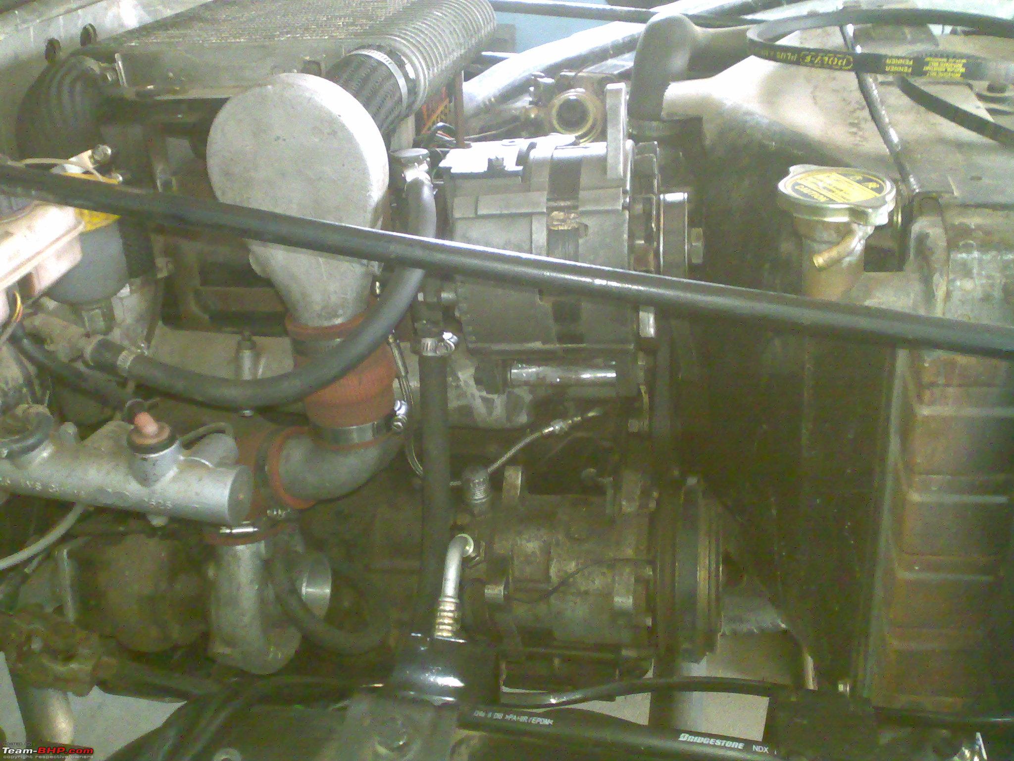

The TATA Safari alternator is 135amps AFAIK. Here is a picture of it on my jeep.
Thanks for the picture and information, however it ignites lots of questions
135amps should be too good to have, what is the nagative side of upgrading the alternator ? Anything such as compromise on mileage, power etc. etc What is the battery that you put on your jeep ?
Could you please post me a overall picture of your jeep's underbonnet setup? What are the alternations we need to do to fix this alternator ? I'm seeing some radiator kind of stuff on the upper portion of your picture posted, what is it ?
I hope the break booster vacuum pump is also attached behind this alternator.
I'm also trying to get my hands on a XD3P engine in the near future. Would it be ok to use the XD3P attached original alternator?

Siva, that Jyobeb's vehicle is completely getting modified. It has a turbo intercooler and thats what you see at the top of the picture
Even a stock alternator would do IMO as you are not going to be winching all the time and All Alternators will only charge the battery until the battery requires it.

A bigger alternator draws negligibly more power from the engine, nothing you should be worried about.
The Safari alternator is huge and if fitted to the right side mid part of the engine, will not create any problem. If it is mounted on top, like in the Bolero, it will foul with the hood and you will need to lower the mounting, as I have done. That said, the reason why I fitted a large alternator is because I have 2 AC blowers, power windows, powerful headlights and a winch which is on its way!
The radiator like thing in the background of the picture is the turbo intercooler.
