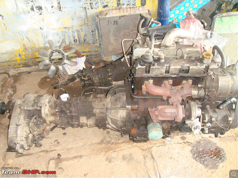

Pics of my 4JG2 engine and MUA5 transmission. Work starts after Diwali.

Engine and gearbox have been removed.
The Isuzu engine is lighter, shorter and more compact than the Scorpio.
The MUA5 gearbox is 3.5" shorter than the NGT530, Borg Warner combo.
The 4JG2 engine is 1.5" shorter than the Scorpio engine

the GB looks brand new.
post some pictures of engine & mounting brackets on chassis.
