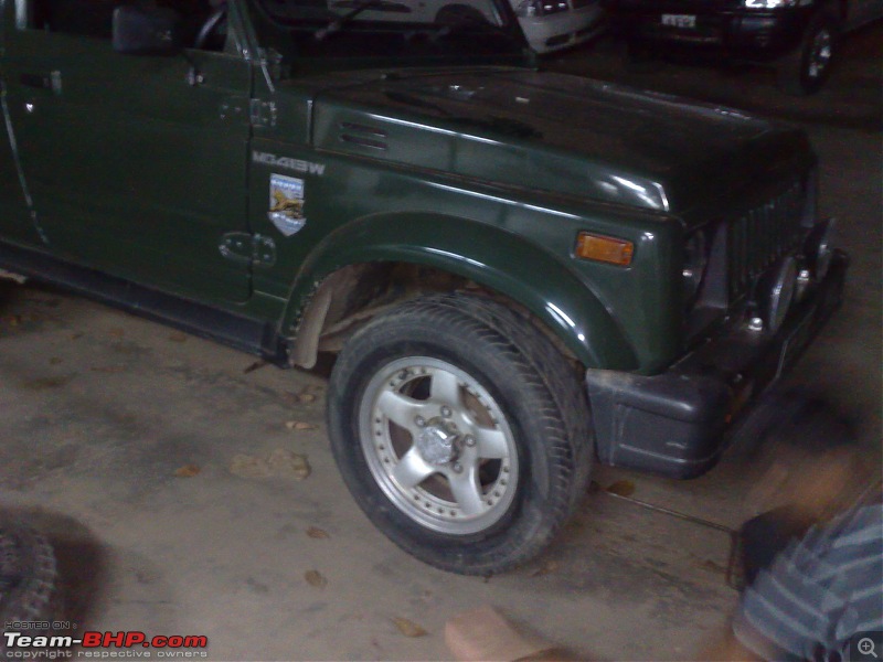

brilliantly documented, i know how much fun it is restoring a gypsy, i have recently done mine, alloys are soon to come!! and i am just being stingy about the tires!i recently swapped wheels with my toyota liteace 4wd and this is how its looking, tell me if i should change to them retaining the big gypsy tires or not......since you are good with gypsys!?i somehow like the gypsy original wheels and i have a set of chrome rim embellishers waiting for them too...confused...

I think you should go for the original Gypsy disc's and tires. Yes the "chrome rim embellishers " look's good. Check out the pic that gypsy belong's to a TBHPian.

OE rims yes, but those rim lips??! definitely NOT on a gypsy for me!
