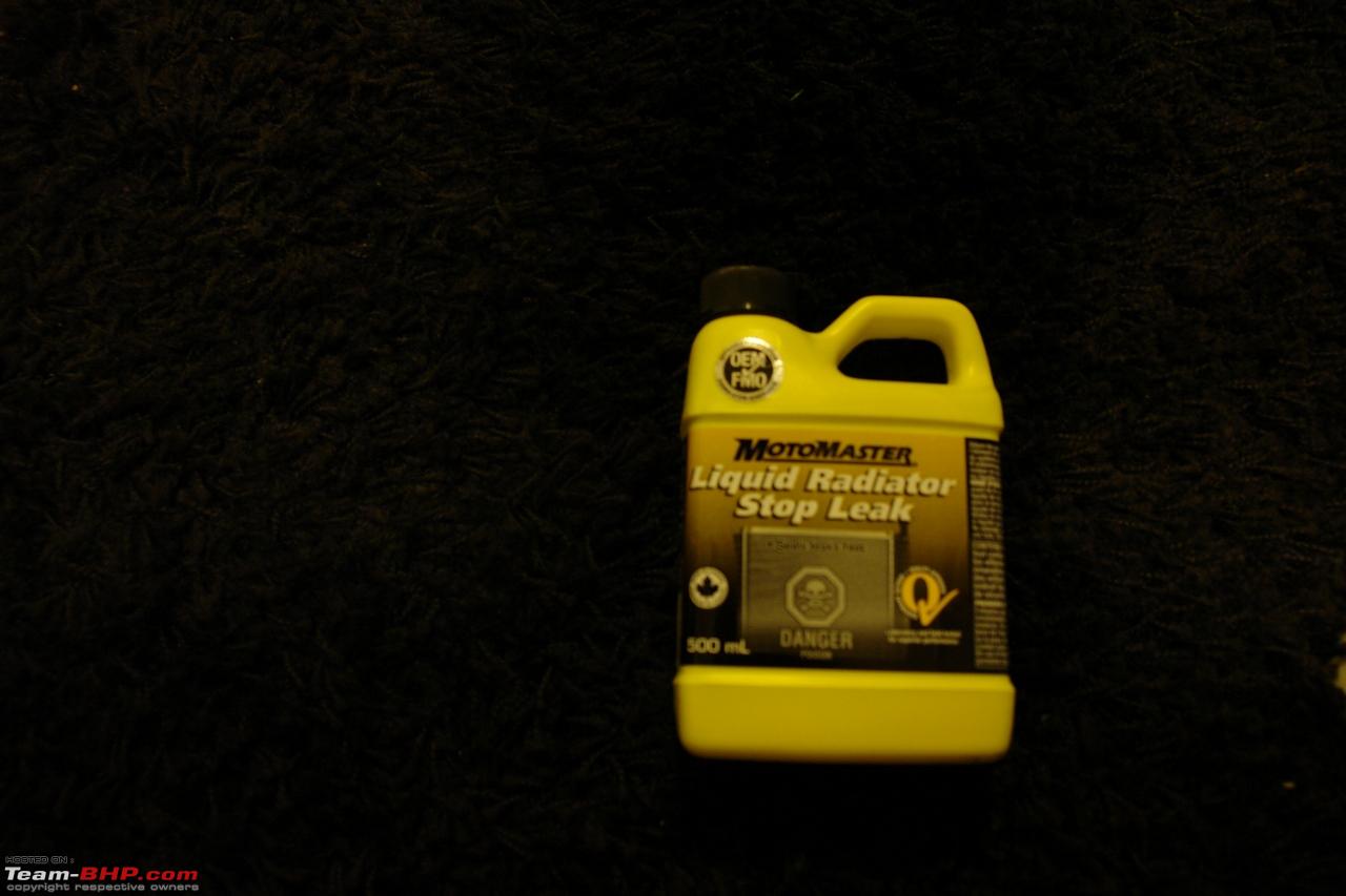

Today i went for some shopping for my Gypsy , the list of items bought are specifically for leh trip:
1) Tire Repair Kit.
2) Radiator sealant
3) 44 piece tool kit(Emergency repair kit).
4) Cables to tie lugguage.
Here are some pics
