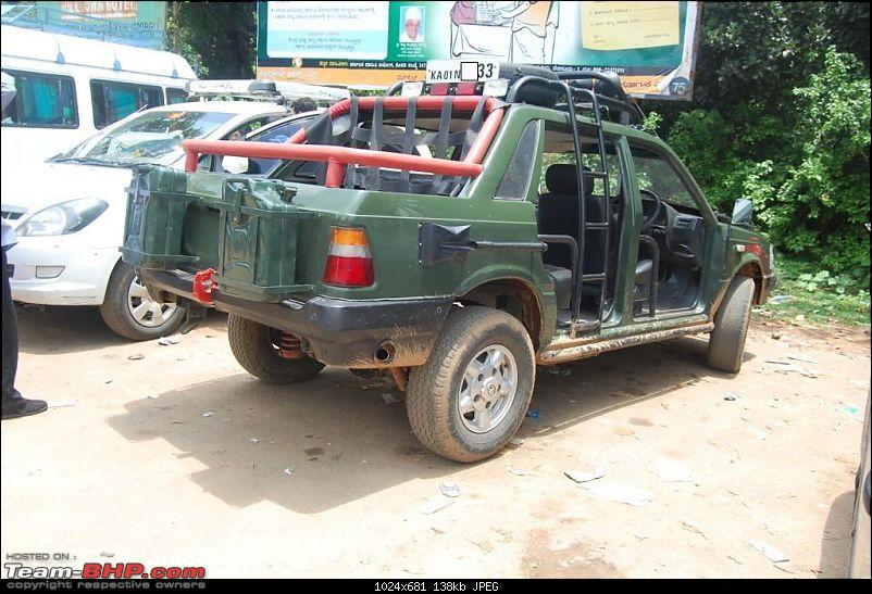

How about the Bolero Camper? Attaching a picture of my customized Camper for reference. It does come with 4x4 and is powered by the DI engine...... It also has a 2 door version.

a great platform for this project .

Why dont you consider a tata sierra? it has good ground clearance and lends itself for immense modification possibilities. This example was advertised on www.carsalesindia.com - price 90K. may be a gud buy if still available - you need to figure out the 4X4 mod though. My suggestion would be to get rid of the back seat and replace it with a wide bench placed in the centre and parallel to the windows. This way the photographers will sit facing the windows in either direction. The swing open doors as seen here can be retained or removed as per the requirement. All the best- happy clicking!
Thinking Aloud : 4wd Offroad capable Jungle Safari vehicle.....the build is on-sierra.jpg

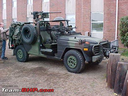

But the Trax looks very promising. Heard from my mechanic that the engine is virtually bullet proof and these looks.... Aha...
Thinking Aloud : 4wd Offroad capable Jungle Safari vehicle.....the build is on-800pxusmc_fast_attack_vehicle_28ifav29_1.jpg
Thinking Aloud : 4wd Offroad capable Jungle Safari vehicle.....the build is on-gallery18.jpg
Although these pics are of the Merc G-wagon - the vehicle on which the trax is based.
