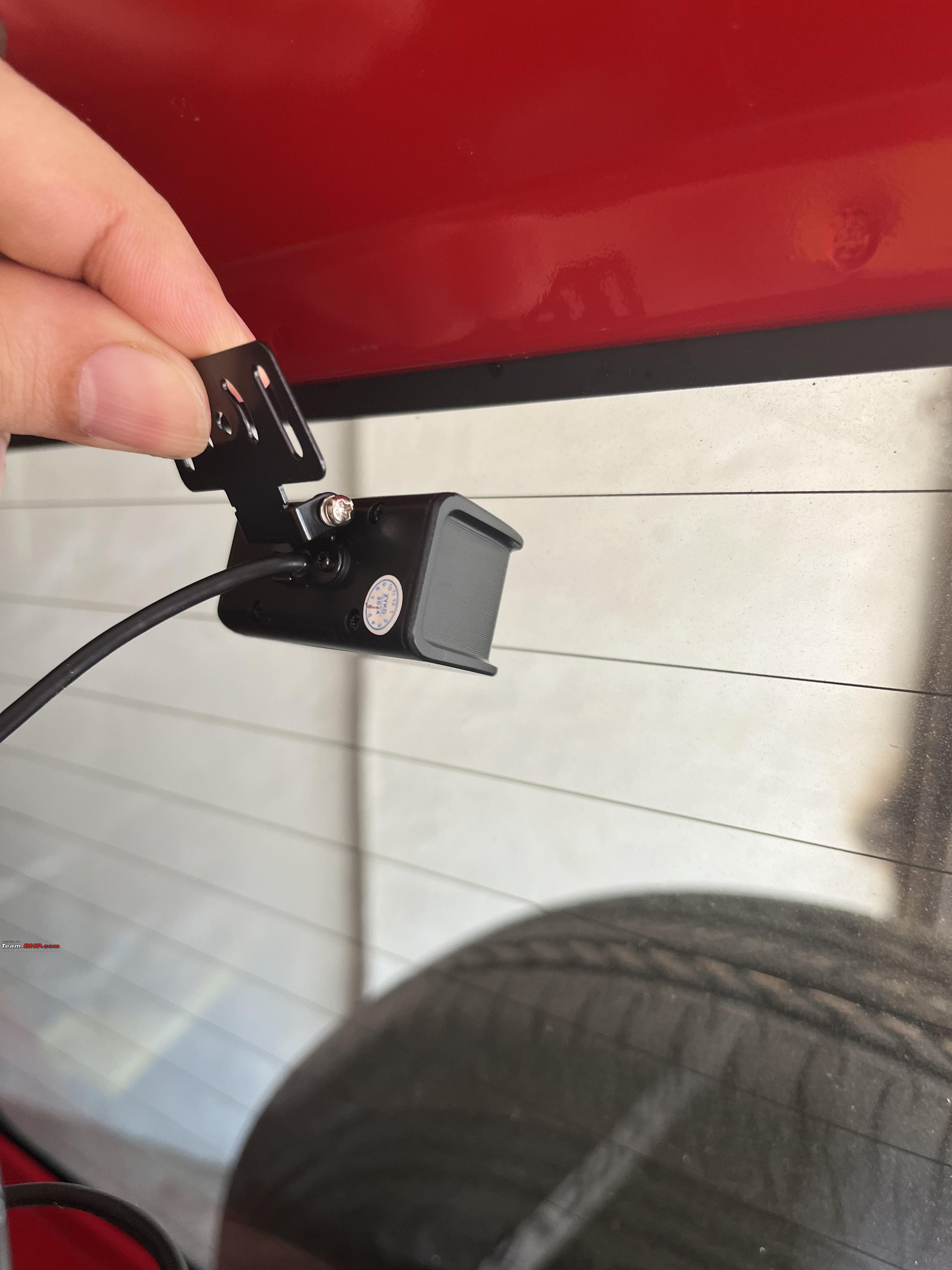

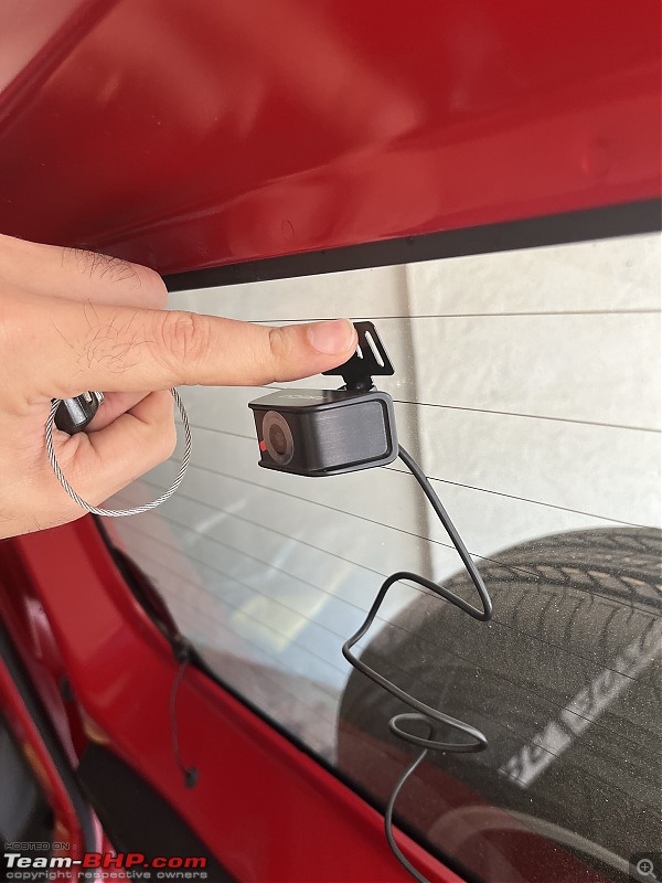

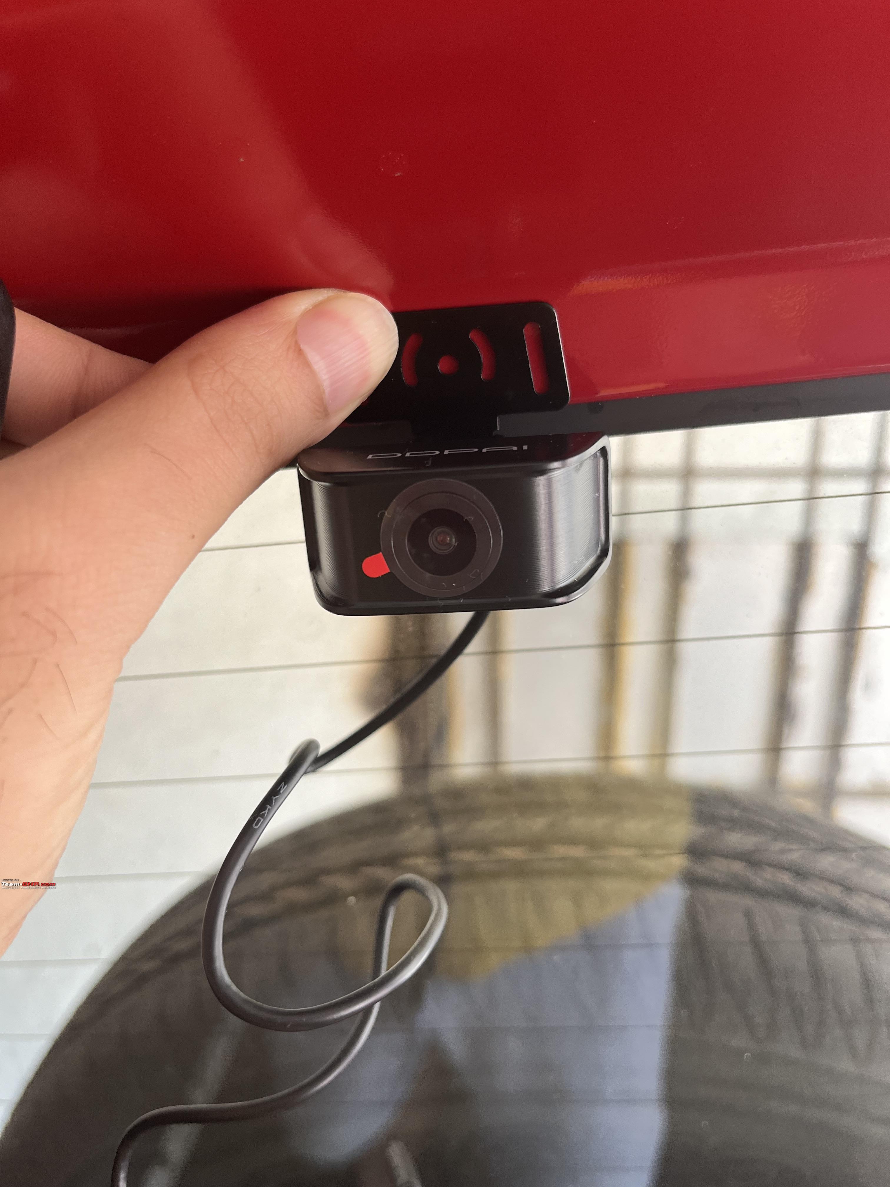

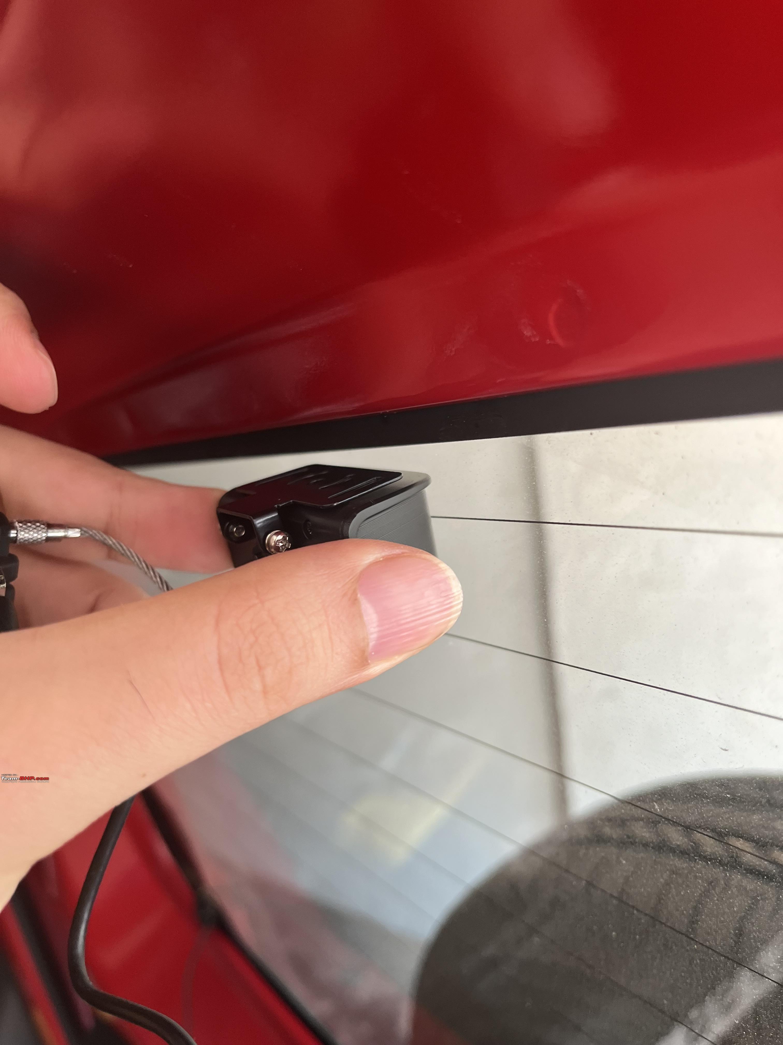

Hi everyone - any tips on how to install this rear dash cam? It’s a DDPAI Mola E3 so the rear camera is shaped like this.
The Dashcam / Car Video Recorder (DVR) Thread-img_2891.jpeg
Don’t want to install it outside for obvious reasons (breakage, theft, general vandalism) and it’s not shaped/built for interior placement in a Jimny with this type of a door style.
The Dashcam / Car Video Recorder (DVR) Thread-img_2890.jpeg
The Dashcam / Car Video Recorder (DVR) Thread-img_2894.jpeg
I think there is a reverse/flip option in the rear camera setup maybe I can install it upside down?
Anyone who has successfully installed a similar looking one do share your knowledge.
The Dashcam / Car Video Recorder (DVR) Thread-img_2892.jpeg
Thanks in advance 🙂
Thanks in advance 🙂
I haven't installed a dashcam like this and don't have a SUV like Jimny either, but would it be possible to install it on the headliner that the door makes contact with. I have seen folks on YouTube who have screwed the dashcam into the headliner :confused: (perhaps it could be attached with some good quality 3M? double sided tape too).
Crude MS PaintJob to put my question across attached.
NOTE: Pic taken from 91wheels for reference. All Team BHP review pics of the boot didn't show the headliner.
Attachment 2670469
Attachment 2670470
Attachment 2670468
Thanks in advance 🙂
https://www.amazon.in/dp/B0CGCBQCZ9/...v_ov_lig_dp_it
I used this mounting accessory to fit the rea cam in my Jimny. Came out perfectly.
I'll send a pic of it once I go to basement.
Thanks so much, even I was seeing this on Amazon. Sadly it only delivers 1 month from now! Guess I’ll have to wait till then. But please do share pics when you can.
