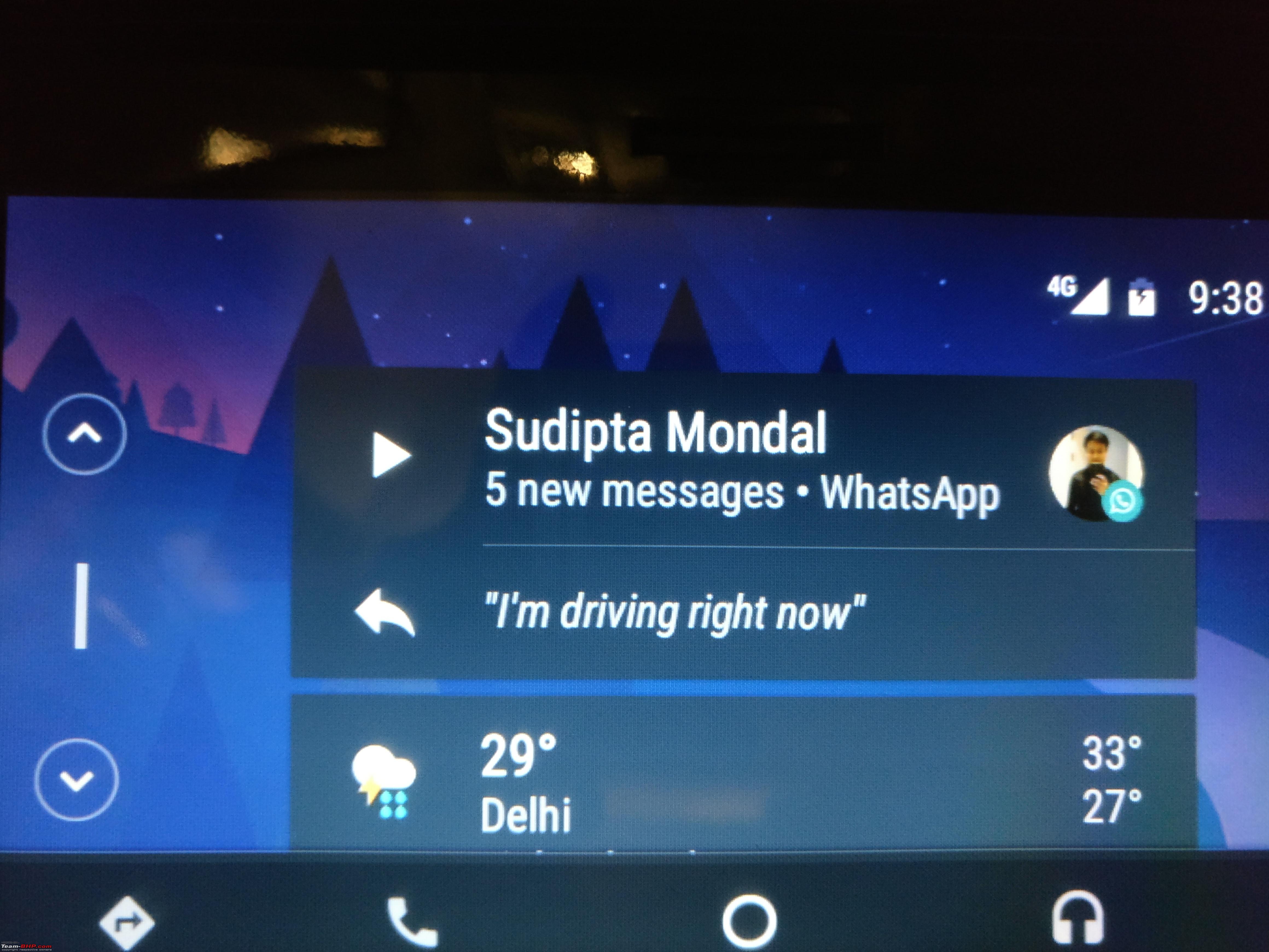

Finally..!!! Made it to see google maps working on my Baleno (Jan-2016 model). Thank you so much to one and all who have participated (indirectly) and contributed to this ceremony of Android Auto housewarming my car. A big thank you to Team-BHP forum and its members. And "Ok Google" too is working flawless. Good that even traffic update is also displayed in the HU.
A few snaps of "Operation-Android Auto in Baleno"

I did the Android Update, thanks to the files provided on Google Drive by fellow members. And I was so happy with the update. It failed 4 times though before successfully updating and I got late for office. lol: Have a look at the screens in the attachment.
Android Auto update for owners of Maruti's older SmartPlay Infotainment System-img_20170721_081303.jpg
Android Auto update for owners of Maruti's older SmartPlay Infotainment System-img_20170721_085848.jpg
Android Auto update for owners of Maruti's older SmartPlay Infotainment System-img_20170721_085856.jpg
Android Auto update for owners of Maruti's older SmartPlay Infotainment System-img_20170721_085904.jpg
Android Auto update for owners of Maruti's older SmartPlay Infotainment System-img_20170721_095647.jpg
Android Auto update for owners of Maruti's older SmartPlay Infotainment System-img_20170721_213848.jpg
