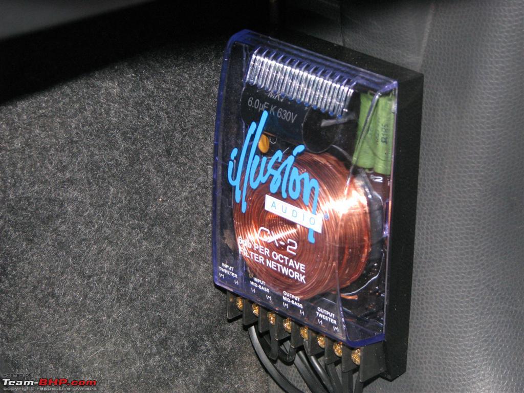

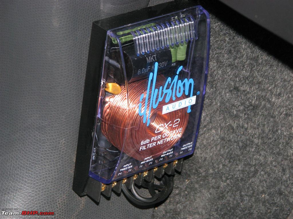

Some pics as requested by a few

one noob question why the crossover has 2 different inputs for the tweets and the mid bass.
I believe that this is what allows one to bi-amp their components.
Bi-amping is running 2 channels off an amp into the same crossover, it gives the components more power, keeps the setup passive, and negates the losses of bridging.
DocG
[I am no guru, happened to have read something along these lines on an international forum]

Nice observation,even i hadn't bothered to see that closely.
