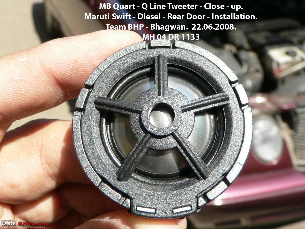

Component Pictures - Close up !!!
Some more snaps - close up.
Cables + Tweeter + Woofer + X-Over etc.
Swift - Diesel - ICE - Steg + MB Quart [Q Line] + Illusion [Carbon].-mb-quart-woofer-install-22.06.2008.jpg
Swift - Diesel - ICE - Steg + MB Quart [Q Line] + Illusion [Carbon].-mb-quart-tweeter-front-close-up-22.06.2008.jpg
Swift - Diesel - ICE - Steg + MB Quart [Q Line] + Illusion [Carbon].-m.b.-quart-tweeter-car-audio-installation-22.06.2008.jpg
Swift - Diesel - ICE - Steg + MB Quart [Q Line] + Illusion [Carbon].-m.b.-quart-xover-illusion-audio-car-audio-installation-22.06.2008.jpg
Swift - Diesel - ICE - Steg + MB Quart [Q Line] + Illusion [Carbon].-monster-close-up-m.b.-quart-illusion-audio-car-22.06.2008.jpg
Swift - Diesel - ICE - Steg + MB Quart [Q Line] + Illusion [Carbon].-monster-cable-m.b.-quart-illusion-audio-car-audio-22.06.2008.jpg
Swift - Diesel - ICE - Steg + MB Quart [Q Line] + Illusion [Carbon].-illusion-carbon-woofer-12-inch-swift-install-20.06.2008.jpg
BHAGWAN is offline
