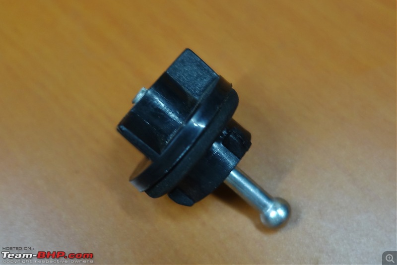

Headlight Leveling Motors Installed
I would like to thank @sunilsoft for providing the part numbers and AliExpress links to the motors and connectors.
I would like to thank Gannu for providing the wiring diagram for the motors in his BiXenon DIY thread
A little background first. The dual barrel headlights that came with my Polo GT TSi had in built leveling motors. When I did the projector retrofit, I had got the previous generation single barrel headlight assemblies and had fit the projectors to these. The single barrel headlights have external leveling motors. The headlight assemblies I got did not come with these motors. So the headlight leveling function was not functional in my GT. Because of this, when I had passengers in the rear seat, the headlights used to point up glaring oncoming traffic. I decided to do a DIY installation of leveling motors.
Got the headlight leveling motors from the below AliExpress link.
Total cost $66 for two motors via DHL. The original cost with DHL shipping was $94. Thanks to information from sunilsoft, I requested for a discount and the vendor agreed to reduce the price to $66.
The headlight motors required a connector. As the motor vendor did not have the connectors, ordered the connectors from below AliExpress link.
Motor Connectors Without Wires
This package comes with 5 connectors, and require wire crimping. There is another source with wires crimped.
Motor Connectors With Wires
I decided to go with the connectors without wires, so that I can have 3 spare connectors.
The motors arrived within a week as they were shipped through DHL. The connectors took 3 weeks to arrive.
The motor

First job was to fix the motors to the headlights. The headlights come with a dummy plug in place of the motor.
Installed! Bi-Xenon Projectors on my VW Polo GT TSi. EDIT - Reliability concerns on page 8-dummy-plug.jpg
This plug has to be first rotated a quarter turn in the clockwise direction, and the plug becomes free. Along with the plug, the reflector also becomes free. Holding the projector from behind to keep the reflector stable, the plug has to be first pushed down to release it from the lock in the reflector.
The removed plug.
Installed! Bi-Xenon Projectors on my VW Polo GT TSi. EDIT - Reliability concerns on page 8-dummy-plug-removed.jpg
Fixing the motor is the reverse sequence of removing the plug. Motor fixed to the headlight assembly.
Installed! Bi-Xenon Projectors on my VW Polo GT TSi. EDIT - Reliability concerns on page 8-motor-installed-1.jpg

As I have explained in the earlier posts, the high beam in the projectors failed and Lumens Systems replaced the projectors under warranty free of cost.
Though I am very happy with the after sales support of Lumens Systems, being an engineer, I started looking for reason why the projectors failed, and how to prevent (atleast try to prevent) similar failure in the future.
When I had inspected the failed projectors, I found that the shutter mechanism in both the projectors had got stuck. As member sid93 had pointed out earlier, this could be due to the shutter mechanism expanding and deforming due to heat. Maybe the projectors are not rated for 55W HID system. When I looked up the specifications of Mini H1 projectors from Morimoto, (the ones installed in my car are Mini H1 replicas), these projectors are rated only for 35W HID systems. Only the latest v7.0 Mini H1 is rated for 50W HID system. In the many threads on various HID forums, people always suggested FXR projectors for 55W. When I analyzed the quality of the failed projectors, the plastic lens holder, the flimsy shutter mechanism etc further strengthened this theory that the projectors are not designed for a 55W system.
Though the new replacement projectors had a better construction with metal lens holder, and though Vinod of Lumens Systems insisted that these projectors will withstand 55W HID, I decided to play it safe and change to 35W. I had read in the "Best Xenon HID Coversion Kit" that in aftermarket kits, Hylux ballasts are of very good quality and CN Bulbs are the best in HID bulbs. Thanks to member Sam.k, I got the link to XenonPlanet who are located in Chandigarh and deal with Hylux ballasts and CN bulbs. Ordered the below from their website.
