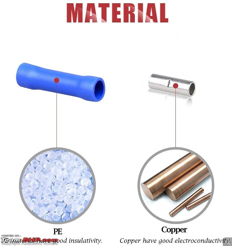

Thank you all for your quick responses. A lot of different ideas for different applications.
I've decided to order a crimp type connector copper product and seal it with M-Seal for a permanent joint in humid conditions.I already own a crimp tool.
It is also the most cost effective and versatile solution for repairing/joining a single wire or multiple wires.
https://www.amazon.in/dp/B07RBQ11B7/...ing=UTF8&psc=1
There is another product that combines the screw type caps and the crimp type connector.
https://www.amazon.in/dp/B00O6LKYSW/...ing=UTF8&psc=1

To join two wires all you need is a soldering iron , solder and flux. Once joined, just use the same soldering iron to close the soldered part using a heat shrink sleeve.

Yes!
Originally Posted by drsingh View Post
I've decided to order a crimp type connector copper product and seal it with M-Seal ...
I wouldn't use M-Seal.
Pedantic, probably, but if something is not sold as an electrical insulator, I would rather not use it as one.
Self-Amalgamating Rubber Tape is good as a sealing outer layer. 3m actually quote safe voltages too. You take a piece off the roll, stretch it to about 1.5 times its length, and wrap with it still stretched. It bonds to itself, becoming one layer of rubber.

The general preference is crimping. Solder is preferred in electronics where the current is low. It is nicely summarised in this article Should you crimp or solder
Crimp where you can, solder where you have to. Though soldering a wire or connection on a vehicle may make you feel like you are doing a better job, in practice it can cause more issues than it may avoid. To crimp or solder will be a personal decision based on experience, tools and preferences, but in general crimping should be the go-to option.
