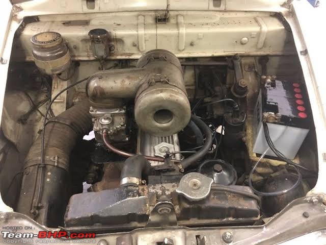

Also can you please share some photos of the location of the bottle in the engine bay?
Yes I can spend on glass glue, I just wanted to be sure if that will work. I want a fool proof solution so asking experts here . Also from the time I posted here have got the brackets made by laser cutting and folding and have modelled the bottle in CAD. I figured out the bottle I got is over sized in diameter, so will not do and thus the cad drawing.
This bottle is available no where and was also used on Ferraris, so the price is usually around 500 USD + Shipping + Customs

No buddy these are all not the right size - I need is 112mm Diameter and 116 mm height with a 96 mm screw cap. But yes I will definitely visit the main market to try my luck, just in case.
From the engine bay photo, I see the increased height will probably foul with the closing of the bonnet. And I suspect there's something running underneath it. But I may be wrong.
Can you mount the new bottle slightly to the left / right and place it a little lower?
Also how is the pipe connected to it, from the bottom?
Yes the increased height will foul and right below is the cross member / stiffener. No I cannot mount it any where else. Dante Giacosa designed / placed it perfectly where it should be.
There will be a small nipple / nozzle (M7 bolt turned half way down to form a nozzle) affixed to the bottom hole to carry the fluid required.
