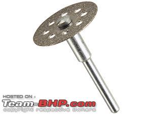

I usually use diamond coated discs on a mandrel with my dremel clone. Works very well on plastics and acrylics.
Like this one:
