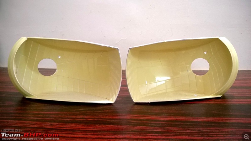

For stripping the chrome off the headlight reflectors.
From this:
To this:

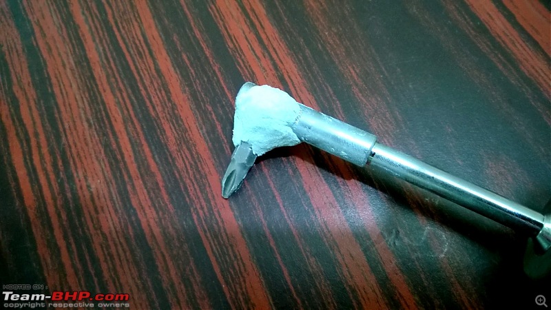

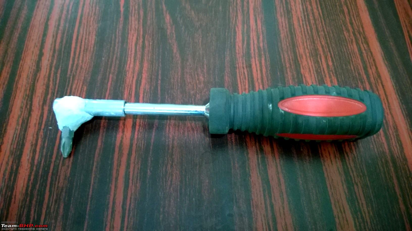

And made a jugaadu right angled Phillips screw driver by attaching the bit to the end of the shaft using some m-seal:
The screw driver had become defective after the shaft started rotating inside the grip. This one is not used for tightening the screw but to hold it in place (inaccessible otherwise) while tightening a nut from the other side. I hope the torque from the other side won’t rip off the Phillips bit from the sealed end!
Sorry about OT, Gannu is that Polo's HL reflector? You were upgrading to Bi-xenons I know, but why were the older reflectors stripped out of its chrome, ie, if that's what is shown in the pics? Just curious. :)
Yes Ajay, those are Polo's stock reflector bowls. Now that the chrome does not serve any purpose, I intend to paint them with a shade of matte black. Was worried if the paint would adhere to the chromed parts properly so stripped the chrome off.
Some folks leave the bowls as it is and some paint them. I wanted to paint them since the chrome had chipped off at some locations and was looking ugly.

Originally Posted by Gannu_1 (Post 3568537)
Yesterday’s loot:
Attachment 1304354
And do you think that's good to strip the chrome from my innova's mirror housing?
Are the stripped down plastics AFTER Mr. Muscle went to work on them?
How many hours of elbow grease are we talking about here?
Yep. This solution should work well. I think this was a wee bit stronger!
Yep, just the bowl went into the solution. The solution is safe on plastics, do not worry. I had my fears as well but then the concentrate itself was being stored in a plastic bottle.
None really. :) Just light scrubbing using a Scotch Brite pad, provided the contents remain in the solution for a good 3-4 hours.
What I used was a bucket filled with water sufficient to have one bowl immersed, 1 no. Mr. Muscle kitchen cleaner (the orange colored bottle) and 2 nos. Mr. Muscle toilet cleaner (black bottle) emptied into it.
Kept the bowl immersed for 3 hours, took it out, scuffed it and all the chrome was gone. You can see parts of chrome floating in the bucket when the bowl is immersed.
The other bowl was immersed after that and left it for the overnight. I woke up at 7 and scuffed the bowl for 5 minutes. Cleaned to a shine. This was easier than the first since it was immersed for almost 6 hours!
EDIT: Very important - The solution smells really awful; emanates a pungent odour! Try to work in a bathroom alone (while the exhaust fan is on or windows open) or in an open space and use a pair of gloves while scrubbing. The skin on my hands had a burning sensation when the solution fell on it. Nothing major though. After cleaning the hands, they were fine.
