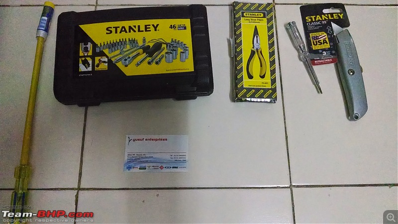

Was in Mumbai on Saturday and had time to visit Crawford Market area.
While searching for Stanley shop in that area, I discovered a 'Stanley exclusive' shop - perhaps a distributor near Nagdevi Street.
Purchased several tools with 30-40% discount.
One of them was this one and it cost me around Rs. 1350 (MRP was around 2200).
All those streets are filled with hardware and tools shops. It is a bit over-whelming to see the size of the market on your first visit. :)

Here is photo of the recent purchase.
