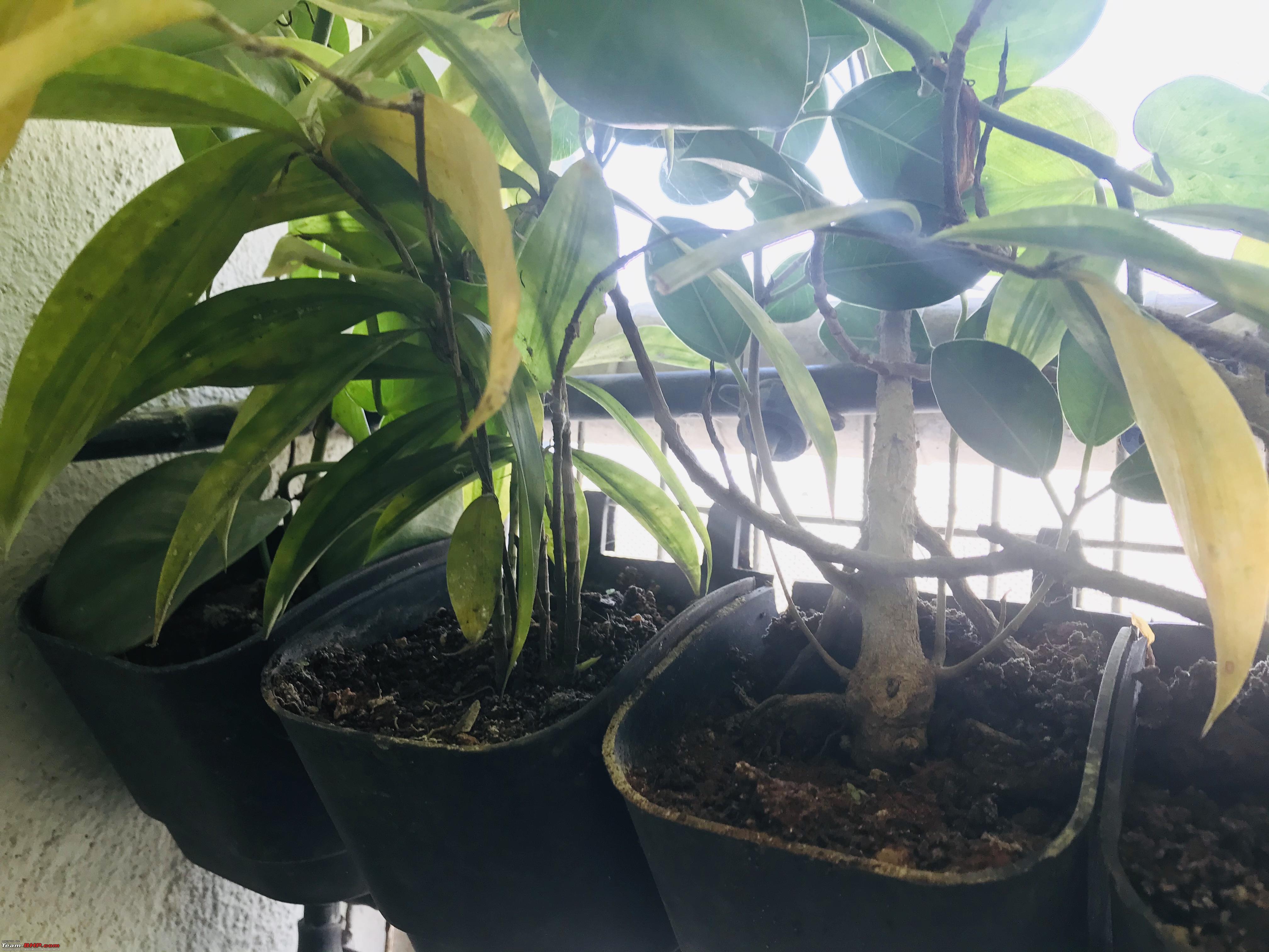

We have a 7 feet high vertical garden installed by a professional. The ELITECH unit barely lasted few months, and repeated tinkering could not resurrect it. So the guy fitted the drip system direct to tap and has turned it by just a mm, and the water 'micro-drips' all day through. I'm planning to get a good system from the US since the ones available in India are of dubious quality.
Originally Posted by Su-47 View Post
I'm thinking about building a simple plant-watering system that will save us the hassle of moving potted plants to neighbor's place whenever we head out on vacation. Objective is to keep it as simple as possible - so, no fancy stuff like soil moisture monitoring, and just need on/off control on a fixed schedule. I've seen sonoff mentioned on this thread, so a question for users: Once programmed, can it "retain state"?
Thanks for your feedback and saving me the pain - Elitech was one of the options I was considering. Looks like putting in a new setup and leaving plants dependent on it, isn't such a good idea.
Keep us posted on what you install and how it goes.
