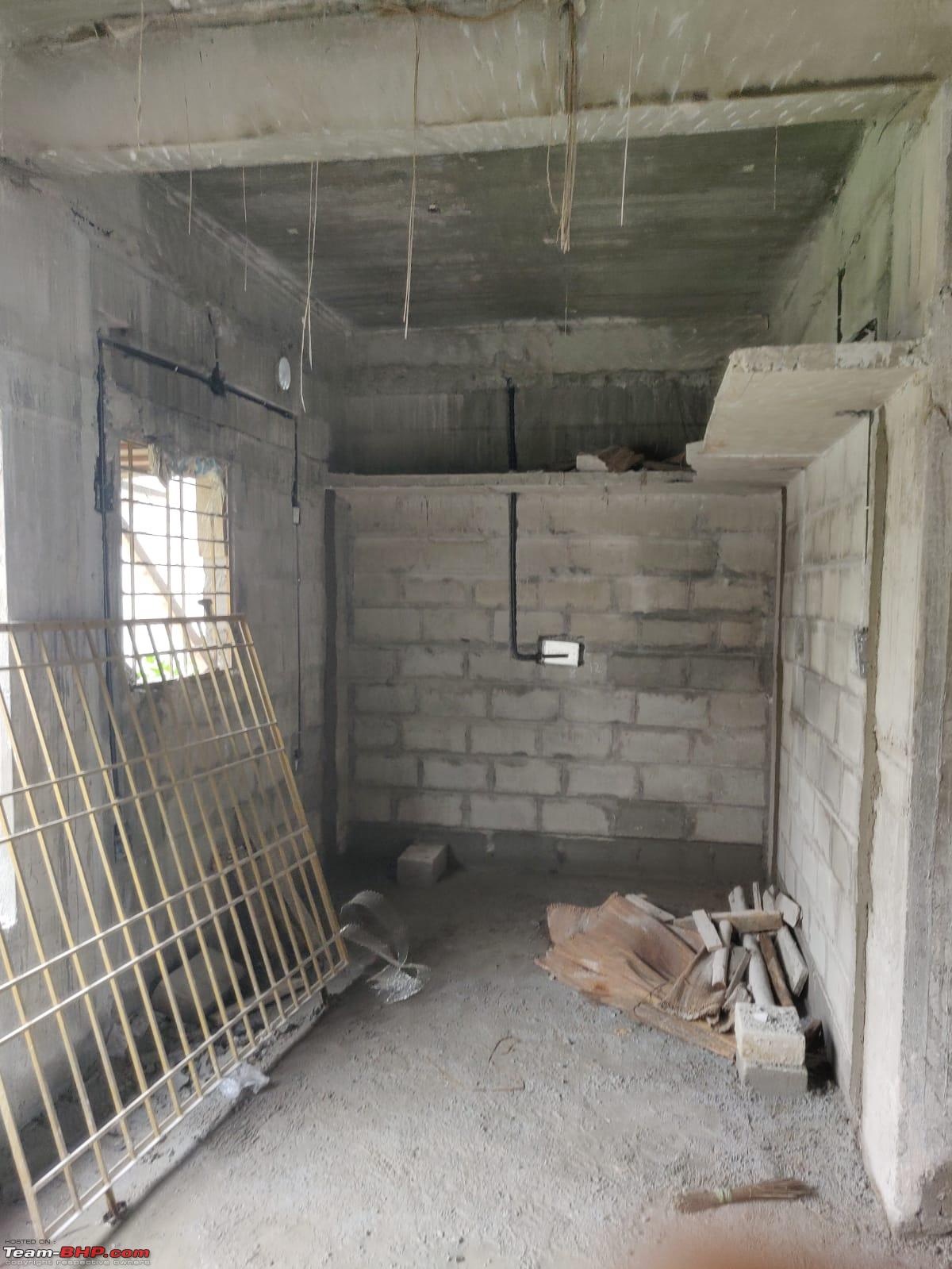

I would like to check if anybody has experience with readymade automation solutions like Curiousfly(https://www.curiousfly.com) and Smarteefi (https://www.smarteefi.com). I wanted to implement home automation solution for my new apartment which is going to be ready in few months and would like to understand the following points before proceeding.
  1. Estimated cost for a 3 BHK house
  2. Awareness for any regular maintenance charges.
  3. Any other points be aware.
Smarteefi has quotation of Rs. 44,444 for a 3 BHK house on their portal. Curiousfly product looks are top notch but cant find pricing anywhere on the web.

Thanks for the response @srini1785. I'm honestly looking for a simple automation solution like touch electrical switches, a Hub switch and control over the switches with a mobile app/remote. Wiring work just began in my unit. I guess, we can still make changes before the plastering work starts.

The metal GI box is placed inside the brick wall before the plastering starts and your touch switch should match that box. Anyways, Check with the electrician.

Thanks @srini1785. Yes, I can see Electrician has already installed similar boxes in the walls. I shall contact these vendors immediately to understand if they have any specific requirements.

Ah yes, Its exactly at the proper moment to incorporate your touch switches. Select the location and type of these touch switches and inform the electrician to provide the conduits, wall boxes and necessary wiring for it. Later it is impossible to do it without cutting the wall.
