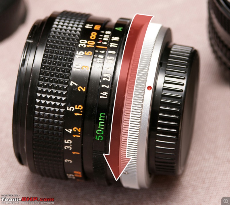

OK, I think a little explanation is needed here.
R lens was marketed till 1962. It was their so called Super Canomatic fully automatic diaphragm control mechanism.
FL lens was manual (not automatic diaphragm). One needed to stop down to desired aperture to get the correct metering with shutter speed combination.
FD lens (full diaphragm) would do the same metering without stopping down the lens.
EF lens (electro focus) is Canon’s autofocus lens. Production started during 1987.
EF-S lens is for APS-C sensor cameras.
Now, the most interesting part of these lens mounts story.
From the time Canon started making interchangeable lens, basic mount design is kept the same.
Originally it was known as Breech Lock mount with a moving metal ring to lock the lens with the body.
One matches the red dot with the red dot of camera body and applies a slight pressure.
Metal ring moves clockwise (see image below) roughly from 12 ‘o clock position to 2 ‘o clock position. Turning it down more (manually) to 3 ‘o clock position ensures proper locking.
However, there was not audible sound to ensure locking. This locking design continued till late 70. Only mechanism change in terms of lens design was manual diaphragm (FL) to full auto diaphragm (FD).
