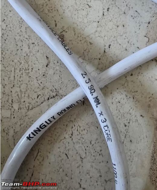

Also what size wire did you pick(1.5mm, 2.5mm etc) and what's the total length of extension cable?
I also have 2 20A sockets in kitchen only and the one in bedroom is mounted high with the ac so unplugging that every time to clean is not worth it.
Yes 2.5 Sq mm * 3 core .
Length as per your need. I had only limited 16AMP sockets around at accessible height and i wanted to use this as car wash extension too hence got around 10 mtrs.
Once plugged in I can run around the entire house vacumming.
But of late I am lazy to do this too and looking at easy cordless vacuums for quick short runs to be honest.
But again you would never get the suction that you get with this and the duration you can run. So this is good for that once in a while deep cleaning.

Coiled meaning the one that has cable coiled around extension box? Or you mean don't let thee long custom wires get coiled around? Or both?
Yes the one which is coiled to save space and flexible. And also dont let the wires coil around and touch when in use. More the surface area exposed more is the heat dissipation. In coiled it puts a hot wire against another hot wire so the heat cannot easily dissipate.

Originally Posted by Kiyon View Post
I have the same Vacuum cleaner and i just walked to the nearby Electric shop and got this Extendor done.
Went to local electrician. Showed him this. Told him to make one for 5m as the vacuum already has a long enough cable to reach every room from a common point almost.
Question: would adding a fuse to the extender make it any more safer than without one? I got a quote of 720 for 5m extender with your sized wires and a fuse and I'm not sure if it includes labour charges.
Is a fuse not needed here or am I being too cautious?
Is there a good brand for these wires and switches one would recommend? I know Anchor makes good switches today.

Well anything extra safe wont hurt.
The device in discussion here is rated 220-230V 50/60HZ with Max 1900W so in theory it should draw no more than 8.64 Amps..
So your fuse should be rated atleast for handling 10 AMP plus. Anythng less then your fuse keeps blowing out and you wont be able to use the device. Tell the electrician that you intend to use this with 2000 Or 2500W(15 Amp fuse) device.
Again you are using this device to draw power from 16AMP heating circuit and in most houses you should already be having a MCB to trip if the device shorts or draws more than that power rating of 16 AMP ( Some times 20 AMP).
I remember paying 1K plus for 10 M with the cable i have posted with Anchor Switch box. I am using from an year with no issues so far.
This is all not worth the hassle if you are happy with the cable length and it reaches all corners of the house from a common switch. All that you need is change the existing point which is stuck with a new one , something like below (quick and easy )
