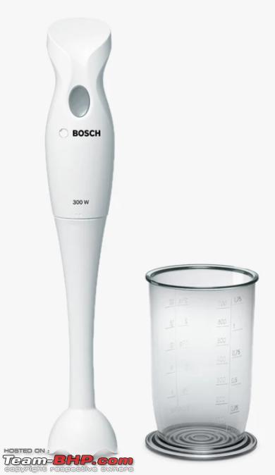

Originally Posted by ron178 View Post
What kind of attachment is this? Our Morphy Richards (Bajaj) has a stainless steel foot but the owner's manual does not recommend use with hot liquids.
Not that it stopped my mum...
Oh just something like this really https://www.johnlewis.com/bosch-msm6...-white/p623273
I still have that one above as it was the cheapo one I got when I moved out but I've long since replaced it with a more powerful model. I found the 1000W rated models far more versatile in terms of what they can work on. The piddly 300W blender kinda struggled with more chunky veg unless you really cooked it down before blending into soup.
