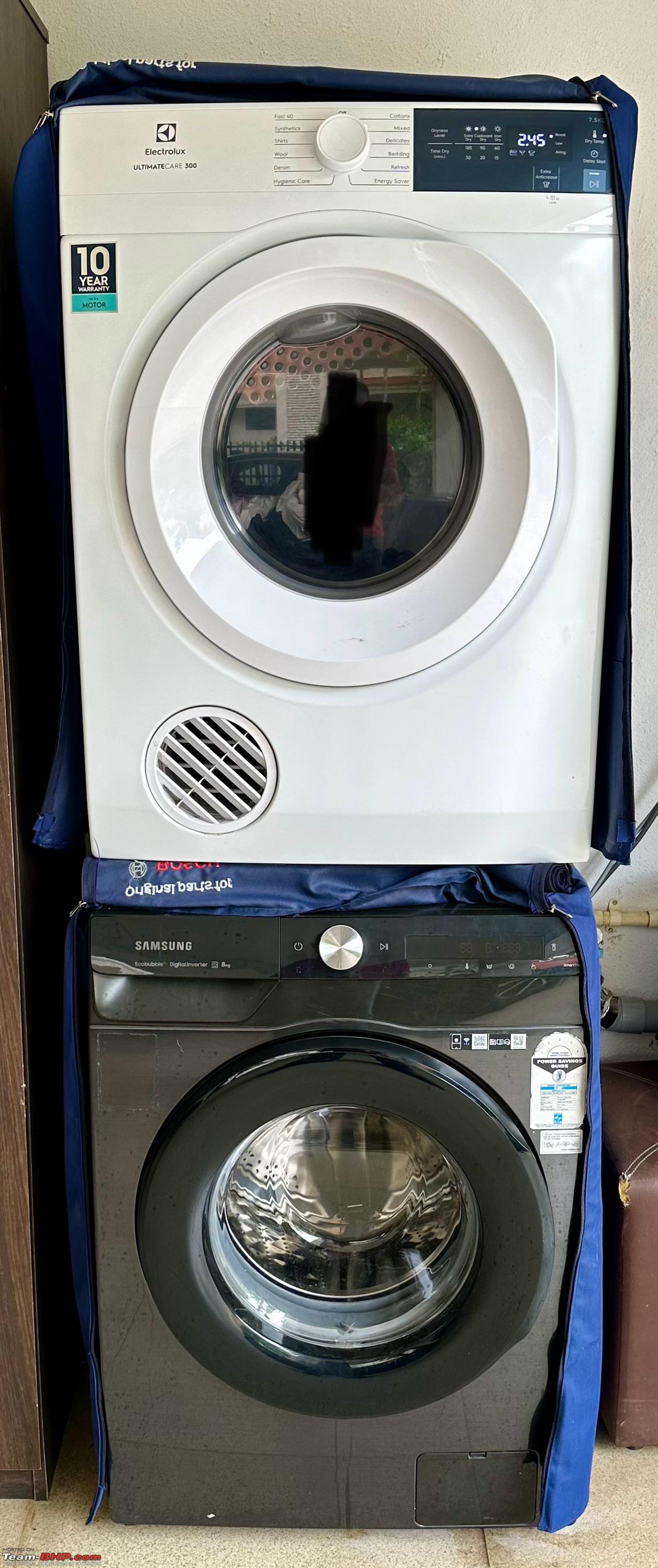

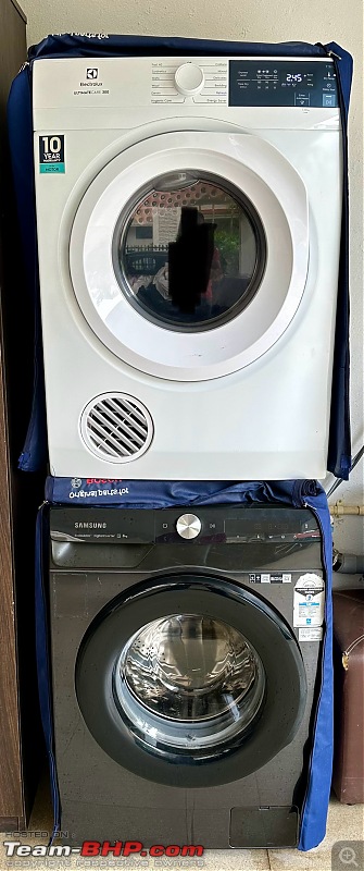

I'd strongly suggest a standalone dryer for your usage. My setup below with anti-vibration pads and Bosch covers. Before someone reacts to the stacking, we rarely wash unbalanced loads and am very careful with the loading. Hence, less chance of the washing machine throwing off the dryer
I don't think stacking is that big an issue, especially if the machine is rated for it (I vaguely remember finding a line in the manual that essentially states as much). As long as the feet are adjusted properly whereby you don't get any movement when the washer is at max RPM, you can stack a corresponding dryer on top, especially the simpler vented types. Those are relatively light compared to the heat pump models. Mostly though having them stacked is just that much more convenient. The halfway house option I have seen is folks building in a heavy duty platform for the dryer to rest on. I've only seen one instance though where that platform was on wheeled channels so you could draw out the dryer if required, a neat feature indeed if wanting to get in behind the appliance. Similarly you could have a panel that slides out to give a space to rest your laundry basket or fold the dry stuff as it comes out. Obviously all of that involves a bit of building the enclosure etc.
I still stand on the hill that if you can, just stump up for a heat pump dryer. Way better in the long run all things considered if you can just get over the initial high purchase cost.
In my humble opinion, machines that can be stacked are made to be stackable. But probably its fine if all is levelled properly.
Agree, but 70K for a dryer? Is the electricity savings delta that substantial?
Bespoke stacking kits also intermittently available in India but prohibitively priced at 8K++.
