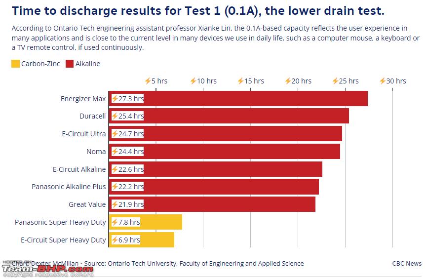

Since we're apparently running for "facts" from the NET, attached is a chart showing comparative performances between Carbon-Zincs and Alkalines under low-drain condition (results of an Ontario Tech University test as reported by the CBC).
I leave with a quote from Dan Steingart, Prof. of Engineering, Columbia University (which rather reinforces a point I'd made in an earlier post):
I couldn't find a single use case where the zinc carbon outperformed in any way the alkaline cells…. There's no reason to sell a zinc carbon system in 2022.
The Home Appliance thread-lowdischarge-comparison-test-_-alkalines-vs.-carbonzincs.png
