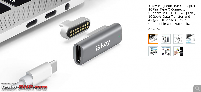

I too have a Dell and I worry about this same problem, though luckily for me it was the adapter pin that failed. However, I can see my charging port getting damaged like yours if I'm not careful, because the new adapter pin is heftier and is more likely to damage the port or the board inside.
Possible solution - magnetic connector:
https://www.amazon.in/Magnetic-Adapt...07TT6NGBC?th=1
I bought this type of adapter, but I got a fake one and the company refunded my money, promised me that if I ordered again, they would send me a genuine iSkey magnetic adapter. I have yet to reorder, but I think this type of magnetic connector is the way to go. I used the fake one with my Samsung phone and worked quite well for a while, so I think it is a good solution. The fake adapter was detected as a keyboard by my Dell laptop, so I could not use it, and it also did not fit snugly in the USB-c port creating a loose connection. Apparently the genuine product works well.

Both have failed for me at different times. However, when they changed the port - it looked like a very simple operation. A socket like part replaced - other than the fact the adapter pin can be replaced without opening up the laptop, the socket looked like a much cheaper part.
Is the wattage sufficient? As I wrote in another reply when I tried a regular USB-C phone charger on the laptop, the laptop said that the charger is less than 27W & hence cannot be used.

Originally Posted by mvadg View Post
I bought this type of adapter, but I got a fake one ... Apparently the genuine product works well.
Go for the newer 24 pin connector. Has been working fine with my 65w type c charger. I have heard incidents of the older 20 pin design shorting the motherboard.

Depends on the board design, my Samsung laptop that suffered this problem had the port soldered to the main board. Others have a daughter board that's easily replaced.
is the wattage sufficient?
Obviously, you'd have to buy a usb-c power supply suitable for your laptop.
I wanted it only for data transfer with the Dell.
Which exact brand is this? Could you please post a link to the item? TIA
