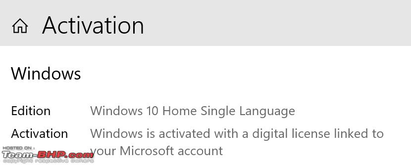

Thankfully, after the Windows 10 Anniversary Update, the product key is no longer solely attached to your hardware. The great news is that you can link it to your Microsoft account. If you arent using a Microsoft account to log in, you could start by doing so and then checking your activation settings to see if your copy of Windows is activated with a digital license or not. See reference image below:
The Laptop Thread: Configs, deals & questions-activation.jpg
I login to my PCs with a Microsoft account (my @outlook.com email address) and all my PC are activated by a digital license linked to the same account. Even if I reinstall Windows on the same PCs, I do not have to do anything new w.r.t activation - they are automatically activated once I complete setup. See here for directions on linking a Windows 10 / 11 product key to a Microsoft account.
As for a copy of the original OS - I download Windows 11 from this Microsoft page. You can either use the Windows 11 Installation Assistant which will download and walk you through the entire process of installation, or, you could download the ISO (see bottom of said page) and then use a tool like Rufus to format and create a bootable USB drive to then install Windows from. It's all pretty straightforward and hassle free. If you are at all prompted to enter a product key during installation, go with the 'I don't have a key' or 'Do this later' option(s).
If you prefer Windows 10, the most current ISO can be downloaded from this Microsoft page.
Please feel free to DM me if you require further assistance.
