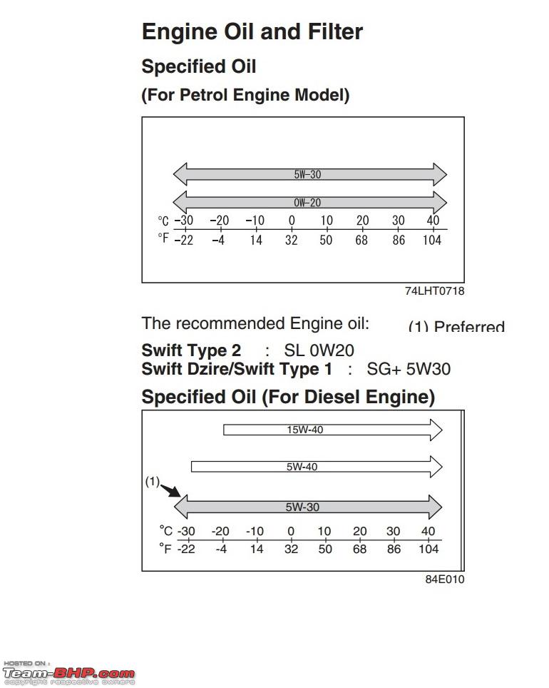

Originally Posted by kaushik51094 View Post
5. engine oil - Can someone please tell me which of these is the proper recommended grade?
Look at the image below take from the Swift Owners manual:
The grey one is the preferred oil for the engine:
1) Petrol Engine (K12M): 5W30 or 0W20 - Either of them can be used.
2) Diesel Engine (D13A): Of the three oils specified - 15W40; 5W40 or 5W30 where the preferred one in case of diesel engine is 5W30.
As per the manual anyone of the grade used isn't an issue so nothing to worry in your case. It depends on what oil the ASC is stocking at that period depending on the availability, movement; commission etc the stocks, manufacturers change.
In my case, when I give my car for service which is every 3 months Once shell helix was used, the other time Mobil was used. So it unpredictable and best left to them.
That solves it then. Thanks for the information
