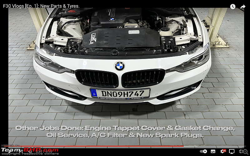

^ In this video you can witness the car installed with a Brand New Suspension, Bushes, Rack components & Fresh Tyres to regain Day 1 feels.
For those who prefer text may read on;
10+ years into ownership & it was finally a good time to refresh the suspension & its parts. The Shocks chosen were OE Genuine BMW Shocks. I was also considering the M Performance upgrade option but that had a drop which I did not want & also aftermarket options were not readily available and were expensive. So finally went in for the OEM option. Ask any knowledgeable BMW guy which is the most comfortable 3 Series of all time & the answer will be F30. F30 genetics were always comfort oriented and I did not want to disturb that as for performance I have the G20 M340i which is an M Performance car with the M Sport suspension (lower than the regular G20 330i by 10mm) & for fun I have the E46 328i which has an adjustable KW coilover setup. Hence for the F30 I wanted to retain the OE comfort levels so went with the OEM option to gain back the original factory feel;
The ULTIMAT3- F30 BMW 328i. EDIT: Upgraded with ///M Exhaust, Injen Intake & Steinbauer Power Module-screenshot-20221225-4.32.17-pm.png
As the 4 shocks were changed it was always a good idea to change other critical components which would have worn out over the years and will complement the new shocks.
New Stabiliser Link Rods;
The ULTIMAT3- F30 BMW 328i. EDIT: Upgraded with ///M Exhaust, Injen Intake & Steinbauer Power Module-screenshot-20221225-4.32.51-pm.png
New Tie Rods;
The ULTIMAT3- F30 BMW 328i. EDIT: Upgraded with ///M Exhaust, Injen Intake & Steinbauer Power Module-screenshot-20221225-4.33.07-pm.png
New Control Arm Bushings;
The ULTIMAT3- F30 BMW 328i. EDIT: Upgraded with ///M Exhaust, Injen Intake & Steinbauer Power Module-screenshot-20221225-4.33.41-pm.png
Steering Rack Rebuild Kit;
The ULTIMAT3- F30 BMW 328i. EDIT: Upgraded with ///M Exhaust, Injen Intake & Steinbauer Power Module-screenshot-20221225-4.34.16-pm.png
As the car was in the workshop some other jobs were done;
The ULTIMAT3- F30 BMW 328i. EDIT: Upgraded with ///M Exhaust, Injen Intake & Steinbauer Power Module-screenshot-20221225-4.36.39-pm.png
New Tappet cover & gasket - As there was a bit of oil sweating observed hence this job was necessary to safeguard the engine & restore performance which may have been missing due to the leak.
New Spark Plugs - The last time I changed the spark plugs was about 5 years ago, hence again a good thing this was done.
New Engine Oil & Oil Filter - Routine.
New A/C Filter - Routine.

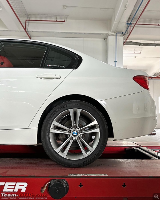

New Tyres;
The ULTIMAT3- F30 BMW 328i. EDIT: Upgraded with ///M Exhaust, Injen Intake & Steinbauer Power Module-screenshot-20221225-4.35.15-pm.png
I have always experimented with tyres & tyre sizes on my F30;
OE size: 225/45 R18 (Squared) - RFT
Experiment 1: 225/45 (Front) 245/40 (Rear) - Michelin Pilot Super Sports - Tubeless
Experiment 2: 245/40 (Squared) - Yokohama Advan Sport V105 - Tubeless
Experiment 3: 245/45 R18 (Squared) - Michelin Primacy 4 - Tubeless
As in this experiment I was going for a higher profile hence did not opt for a drop or other aftermarket options as the OE seemed accommodating 45 profiles. Hence this comfort oriented tyre profile and model selected (Primacy) was tuning the F30 as a Performance Comfort Tourer.
Alignment being done;
The ULTIMAT3- F30 BMW 328i. EDIT: Upgraded with ///M Exhaust, Injen Intake & Steinbauer Power Module-screenshot-20221225-4.36.25-pm.png
Time for a test drive;
The ULTIMAT3- F30 BMW 328i. EDIT: Upgraded with ///M Exhaust, Injen Intake & Steinbauer Power Module-screenshot-20221225-4.37.39-pm.png

Interesting that you're running 245/45. I've seen that configuration on an F30 and it looked like it might rub on the inside, especially under a full load.
Are you experiencing any rubbing at all?
Hi ghostrider, there's no rubbing noticed so far on solo runs as well as with 3 pax & luggage.
Here are some more pics (Closeups) for everyone's reference;

The video at (6.41 \ 8.49) point mentions "Engine tappet cover and Gasket change". This got me curious:
(1) By new "Engine tappet cover" do you mean "Plastic valve cover"?
(2) By "Gasket change" do you mean "Valve cover gasket kit"?
1) Yes;
The ULTIMAT3- F30 BMW 328i. EDIT: Upgraded with ///M Exhaust, Injen Intake & Steinbauer Power Module-a16e11426fe44b888b7f92c1b7991405.jpg
This comes in as a set. Also was recommended by the workshop as mandatory procedure, presumably as there was some internal design change. Also did not want to retain the old cover anyway because of the age of the car and intentions to keep it healthy for another decade at least.
2) Yes;
The ULTIMAT3- F30 BMW 328i. EDIT: Upgraded with ///M Exhaust, Injen Intake & Steinbauer Power Module-bb94da313cf647bcb0f57c84cd85ade2.jpg
Another question: Did the manual mentioned such a change or the SA during his diagnosis figured it out?
This oil sweating was observed & job was recommended to be done soon during the last service in 2021 hence anyway had to be done during this one.
Another question: Isn't it a good practice to replace ignition coils along with spark plugs? Yet, only spark plugs were changed in your car!
Not necessary, but new Spark plugs were recommended as per the scheduled change defined in the guide where as no mention about the ignition coil change.
