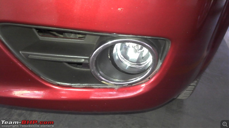

Looks like this was the wrong place to post the fog lamp query. But soon after posting it in the modifications/ lighting thread, I got several suggestions. All of them said that after market fogs will not be as good as OEM ones.
Therefore, before deciding to spend 5000 bucks on a new set of fogs, I consulted the accessories shop near my house from whom I bought lots of stuff like sun film, reverse camera, perfumes, etc. He said he'd take a look at the damaged car by removing the bumper, if needed. If the damage was not possible to repair, he said he'd order a set of fogs for around 1400 bucks, or imported ones for around 3000 bucks.
He got the fog lamp chrome holder removed first from the bumper. It is held onto the bumper by a couple of clips on the plastic bracket with horizontal slats. He then could easily retrieve the fog that was dangling. On examining it, we found a plastic housing encircling the fog completely. There are 4 screw holes on it that should be aligned to the bumper assembly, out of which the top 2 were broken.
As the bottom two were intact, he inverted the fog after adjusting the bulb direction (this direction change be done with a screw driver) and fixed it to the bumper assembly. This was a tricky job that needed him to slide under the bumper and carry out his work.
The results were more than satisfying. Everything works fine now. Only on closely peeping into the chrome socket, one can see a small gap between the socket and the fog at the bottom portion. But heck, I don't want to spend 5000 bucks only for that almost non-existent issue.
To convey my gratitude, I paid him Rs 150 and also bought some items from him like perfume, nets for the boot, etc.
What annoys me is that why Ford A.S.S. could not think of this solution for the past three years. All they were doing was to elevate the car on the hydraulic ramp and place the misaligned fog in the chrome socket. But a big pothole would dislodge it soon. It was only in my last visit in Jan, when I got my reverse light switch changed, that a new S.A. said he would try some makeshift arrangement when I gave the car for its next service. But hey, that will not be till September or October.

Here are pictures of my fog lamps on either side. You can see that there is not much difference.
The original, undamaged one on the right:
My Ford Fiesta 1.6 SXI completes 13.7 years and dies by drowning!-20130521_105554_215.jpg
The damaged one that was fixed on the left. Only a small gap exists with the chrome casing:
My Ford Fiesta 1.6 SXI completes 13.7 years and dies by drowning!-20130521_105613_166.jpg
