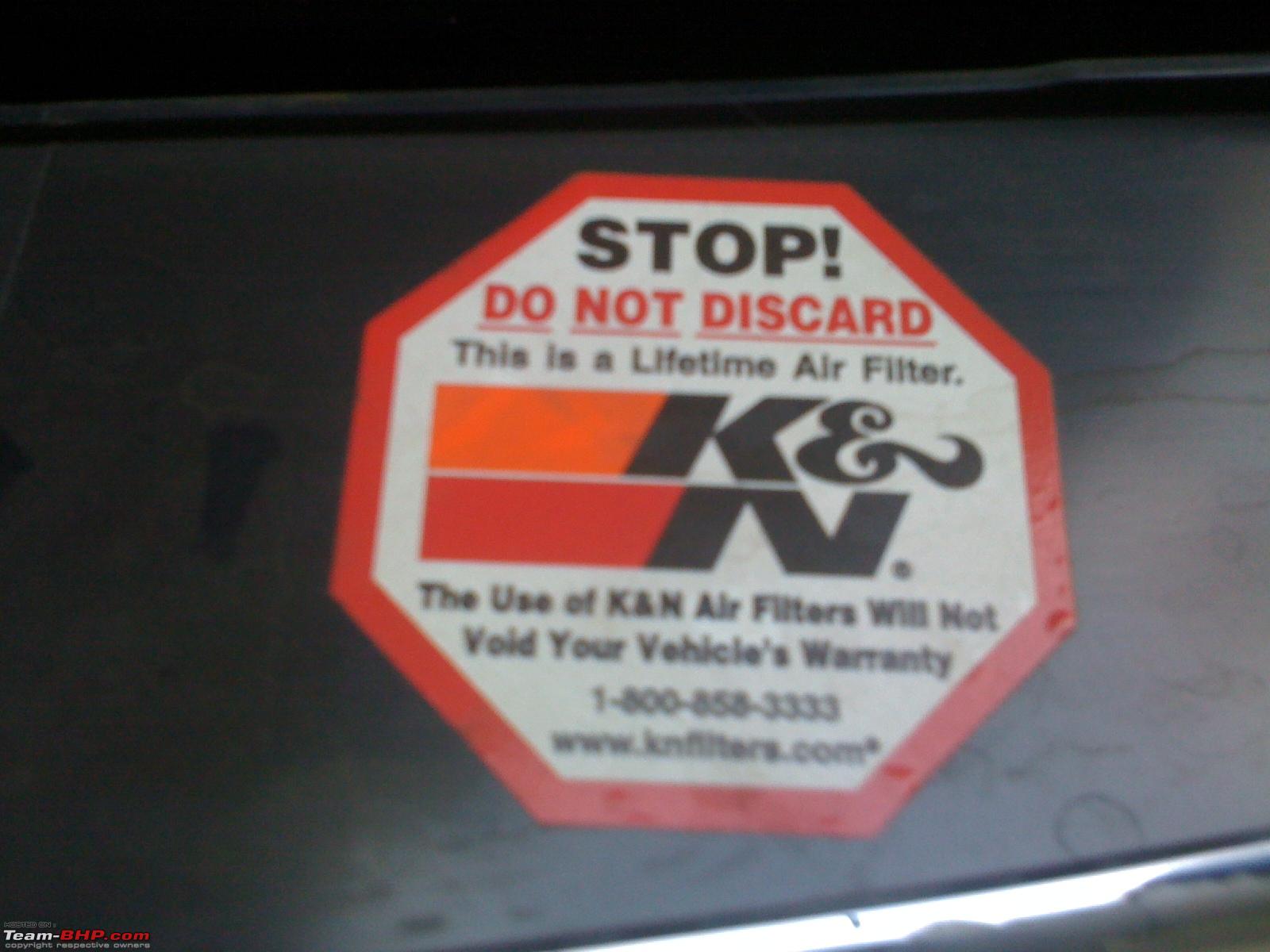

2. With a Pete's or anyother tuning box. Air Filter cleaning intervals go up and its best to clean them every 2k-2.5K kms. I used to DIY the cleaning and trust me lot of soot used to get collected on my green cotton air filter.

I clean my filters almost every 30 days or 1000kms and can definitely see an improvement in performance and lack of smoke.
Never tried multiple settings thought. One thing i always do is clean the filters everytime i clean the car. I just use a Vaccum cleaner or a simple tap to get the dust out. This helped a lot. I havent used the other box but would not mind recommending the Petes for a swift.

Some Pics of my car and the Spider Tuning Box. Will get better pics today.
