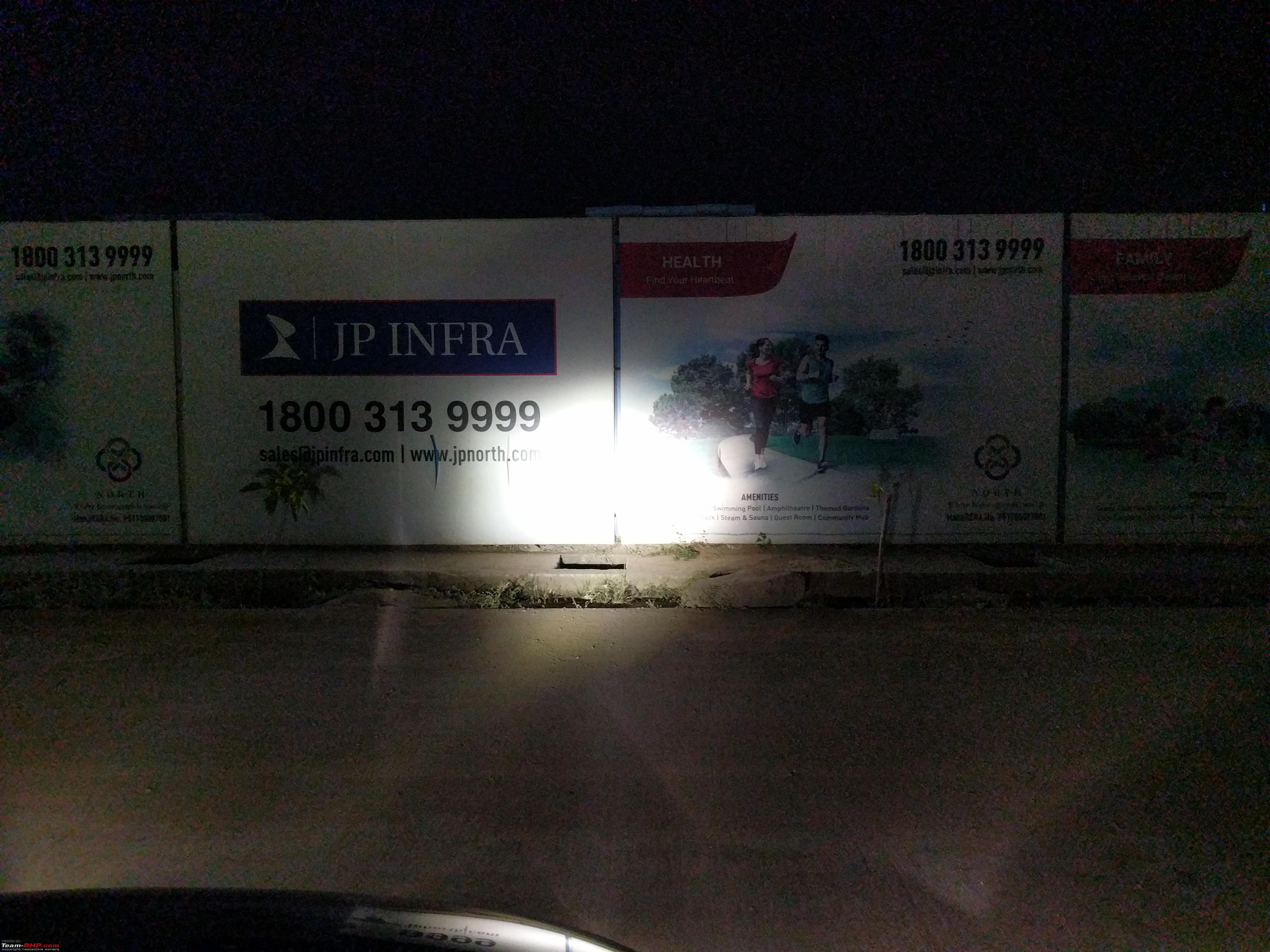

Originally Posted by nidhinsarath (Post 4692977)
The pic is with both the high and low beam in on position. But my low is projector whereas high is normal halogen but both led bulbs are same. The guys checked once gain but couldn’t correct the right alignment.
Projector- low beam
Attachment 1934983
Projector with high
Attachment 1934984
Light throw with only projector
Attachment 1934985
The projector focus looks good. It can be pointed down a little bit so that it will illuminate a bit in front of the car. Since the Projectors looks good, the shadows should be from the high beam or the fog lamps , I would suggest you reach out to Skoda service center and get it aligned

Fog lamp was not ON in the above pic. So you mean to say that the problem is related to faulty alignment?

Originally Posted by arundeepbv (Post 4692855)
The lights are not aligned properly. I'm not sure if in the above photo you have switched on both the high beam and the low beam , but irrespective of that we can see a lot of shadows. One of the reasons would be that the bulbs are not aligned. The LED's should be in positioned to the 3'o Clock. The manual should throw more light on it.
The circled area should have the hot spot of your low beam.
