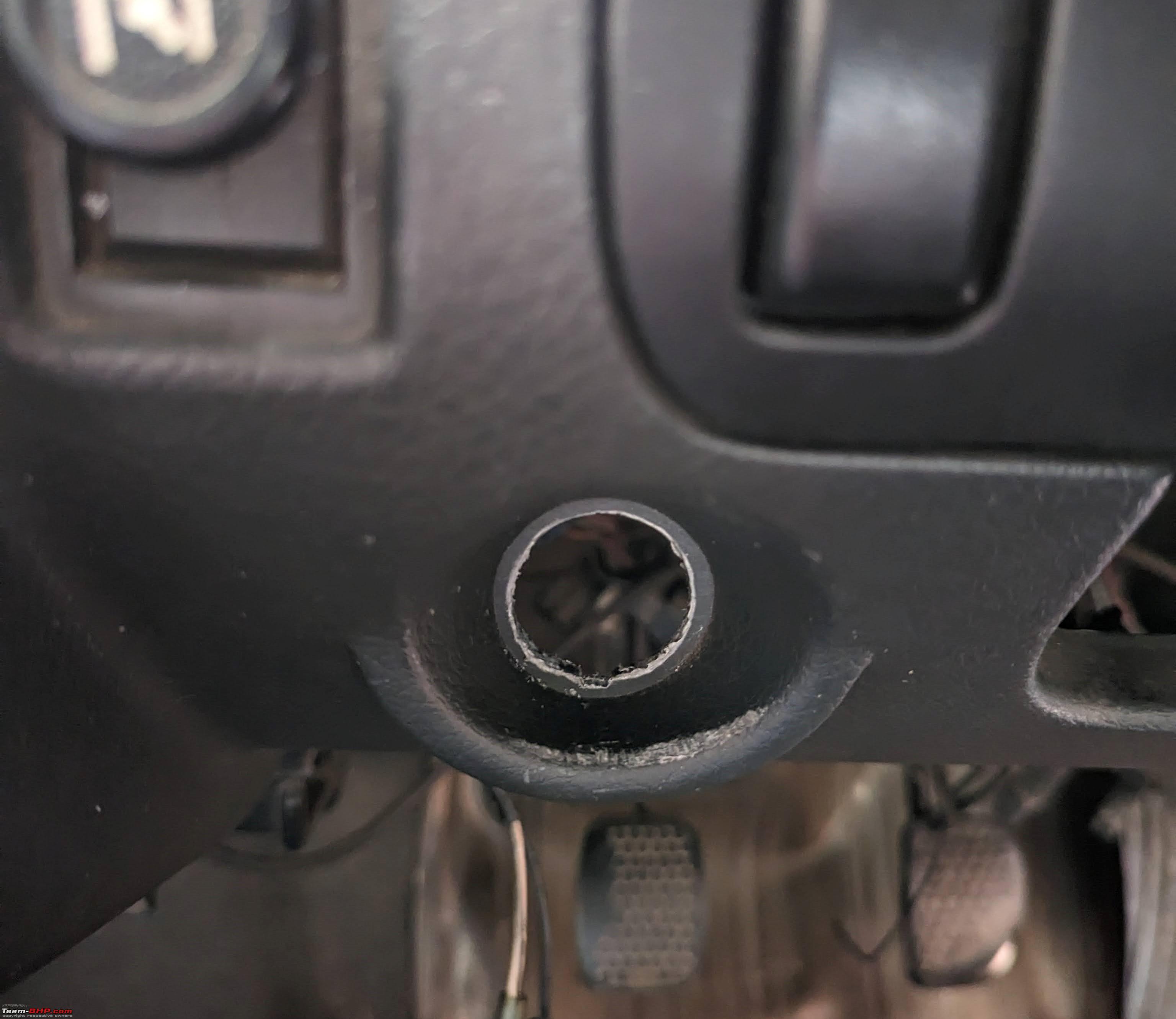

Hi all, A small but obvious mod that I recently tried on out Zen. Adding OEM Charging Socket.
I have been wanting to try this for quite some time now, but things didn't materialize until recently when I finally made up my mind. There were a lot of aftermarket Cigarette lighter options available, but I wanted to go the OEM route.
Parts Used
1. BODY, SOCKET
Part No.: 39420M83P00
Link: BODY, SOCKET
2. HARNESS ASSY, SOCKET
Part No.: 39460M63J00
Doner Car: Swift 1st Gen(2007-2011)
Link: HARNESS ASSY, SOCKET
3. COVER, SOCKET
Link: COVER, SOCKET
How it all started?
Recently I was working on the Stereo when I see this pair of wires hanging round unconnected, but well insulated. Upon checking the fuse box, the wiring was actually for connecting a Cigarette lighter. They also would slot in just right onto an aftermarket cigarette lighter. Until this time I thought this was just a dummy hole with a cap to cover it.
Dummy Cap:
Now, I could have gone ahead with the aftermarket option, but I didn't want to. So, now came the major challenge, finding a donor wiring harness. A quick search online revealed a match, a socket wiring from 1st gen swift.
Coming to the slot itself, it was pretty small for the Socket Cover. Thus, this had to be filed a little.
Filing the slot to fit.:

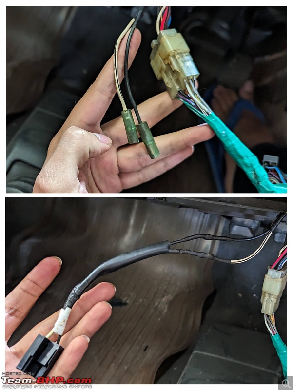

Now that this was done, next was to prep the wiring. Soldered the leads together for this.
Donor Wire.:
Replacing the stock wire replaced with the connector:
Test Aparatus:
Final Result:
