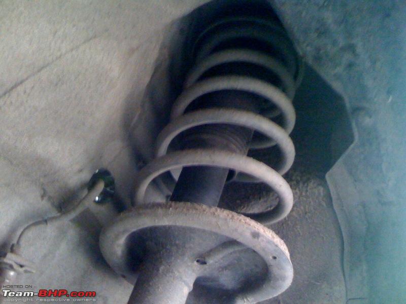

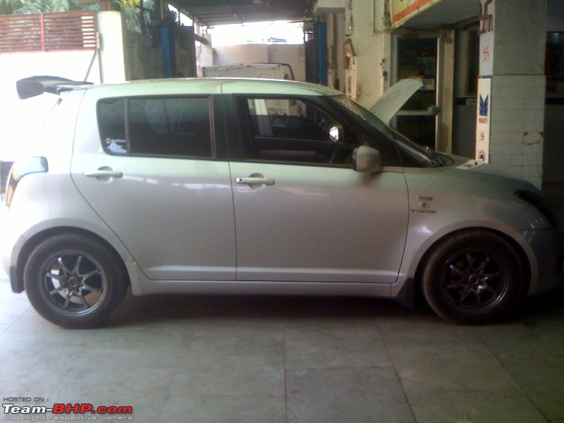

Another update. Got "EIBACH'D".
Replaced the springs only, On the box it was mentioned a 30mm drop, But on my car it seems more than that.
The changes i found in my ride were Handling,which was quite obvious. Driving confidence has increased by large. Switching 3 lanes at 140-150 was like a piece of cake. Body roll DOES NOT EXIST. Breaking seems to be more effective as the front is not diving any more. Cornering is way more confident.
But on the other hand, Ride has gone down the quality is now directly proportional to the quality of the road. One major problem that has come up is that if the road has bump or slight level changed the car's front tents to LIFT OFF/bounce off. Front wheels go in the air and i loose control. Now that is scaring me. Because the confidence is making me drive faster but undue change in the level of road is getting me into trouble. Need help on this? Any one else with spring facing this kind if problem.?
The problem of suspension bottom out is there as well but i cant complain about that as i knew that was bound to happen.
Need your suggests/advice/solution

Thanked: 253 Times
I had tried something similar to stiffen the suspension setup.I had tried H&R springs but apparently the combo of stock shocks and lowering/stiffening springs didnt work out quite well.So went back to stock.
My personal opinion is that Its better to go for stiffer shocks and stiffer springs so that they compliment each other well.
I maybe wrong on this though but this is what I personally feel.
Amey is offline
Old 24th March 2010, 21:41   #294
Join Date: May 2008
Posts: 1,704
Thanked: 852 Times
Those springs will kill old shocks, specially stock ones. Go with aftermarket shocks since the Swift has good aftermarket support in that area.

Same here. The car was fun to drive but it had a lot of side effects. Specially the lift off and the bounce
Yup future upgrade planned for now the car is back on stock.
Originally Posted by s3va View Post
doesnt your wheels scrape the fenders when fully loaded ?
No it did not. The spring made it very stiff for minimal movement.
