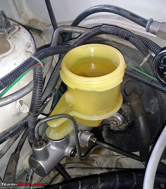

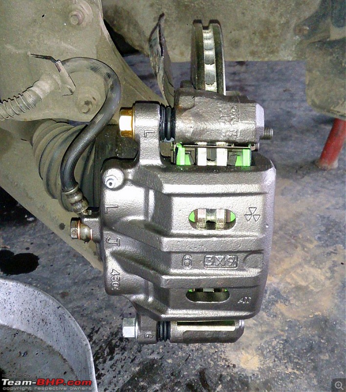

Big brake upgrade -
Parts needed -
  • 1994-1999 Mitsubishi Eclipse GSX (Turbo AWD) Dual Piston Calipers with brackets
  • 2000-2002 Mini Cooper S Brake rotors (94-99 Galant works but it is 114.3 x 4 PCD whereas this is 100 x 4)
  • Brake pads
  • 1994-1999 Mitsubishi 3000GT VR4 Brake Master Cylinder (Not necessary but highly recommended)
By using the above mentioned parts, you can have a very effective but cheap big brake upgrade which is bolt on. No modifications are required whatsoever.
I'll let the pics do the talking,
Engine swap/Performance mods in Lancer-1.jpg
Engine swap/Performance mods in Lancer-2.jpg
Engine swap/Performance mods in Lancer-3.jpg
Engine swap/Performance mods in Lancer-4.jpg
Engine swap/Performance mods in Lancer-5.jpg
Engine swap/Performance mods in Lancer-8.jpg
Engine swap/Performance mods in Lancer-7.jpg
Engine swap/Performance mods in Lancer-9.jpg
Engine swap/Performance mods in Lancer-11.jpg
Engine swap/Performance mods in Lancer-10.jpg
Installation took a couple of hours so you can imagine how easy it is.
As for the performance, well it is pretty evident. Right now I am bedding in the pads and also haven't got an opportunity to test them well but whatever little I drove last night was sufficient to hint at what they are capable of.
Infact a Civic almost rear ended me thanks to my generous braking which I have got used to since the earlier brakes were struggling to slow down the car, forget braking
Willl update after a thorough drive.
Since I carried the parts from US, it saved me a lot of shipping but for the curious ones, I ended up paying ~ 35k for Rotors+2 x Pad Sets+Calipers+Master Cylinder.
More later...
