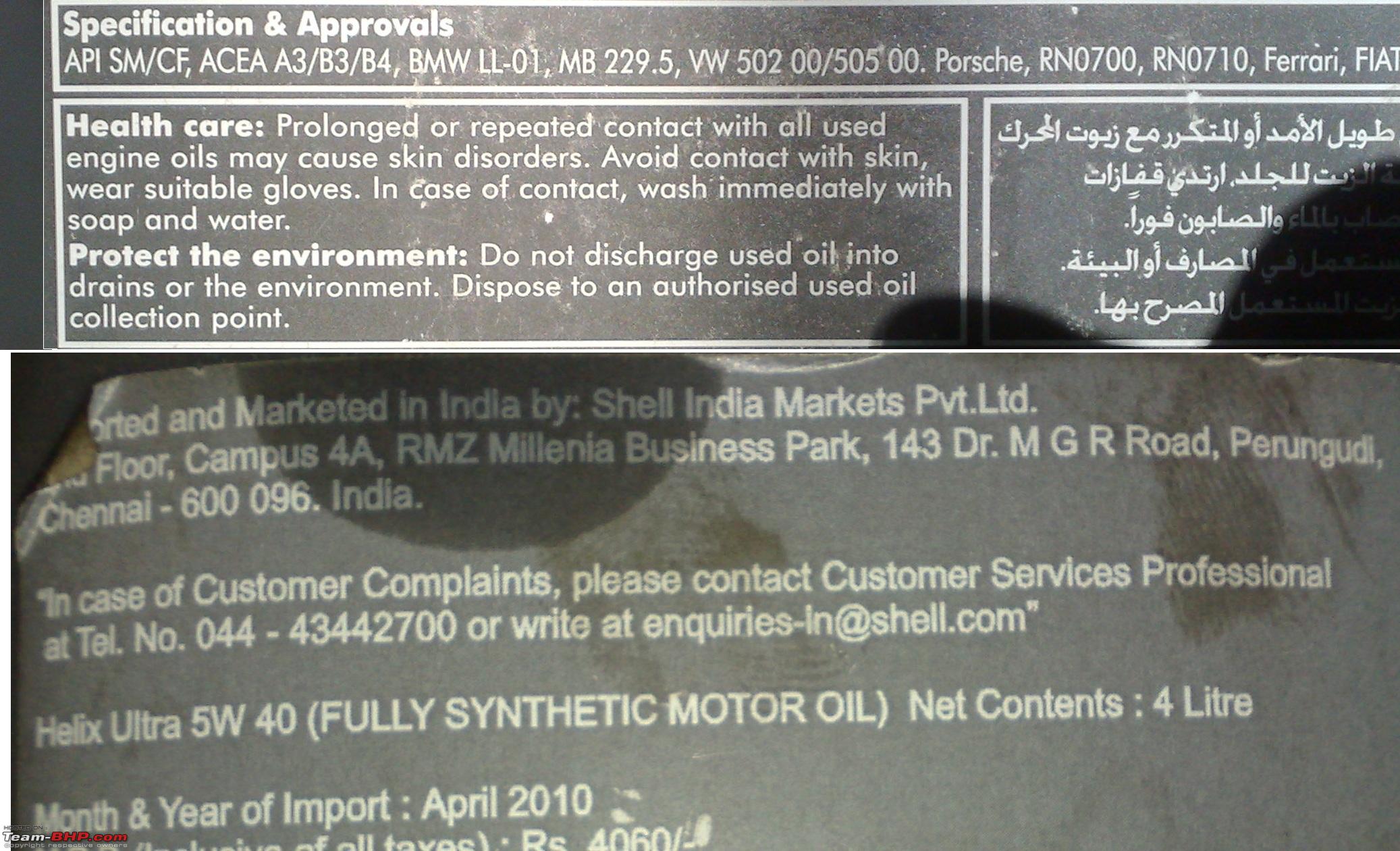

Please see the attachments. MRP of Shell Helix Ultra 5w40 fully synthetic engine oil in chennai on the 4L can label is Rs.4060 which was the same price offered to me in a shell petrol station. But I got it for Rs.3400 from a motor shop (Patel motors,Tambaram,chennai).
Please read the Specification & approval in the can label that I have attached. It has a whole list. Does that mean that this oil meets all those specifications?
Also read the text on the can label that tells what engine can use this..
After changing to Shell Helix Ultra 5w40 fully synthetic engine oil in my swift vdi abs, the first day i was able to feel only a little bit of change but after driving for 3 days now, I fell the smoothnes significantly and the entire NHV has gone down a lot. Idle noise is much low and the engine revs like anything in all gears. Gear shift has also become much smoother than earlier and also what I was able to notice significantly was that the low end torque, that is, leass than 2k rpm is extremely great in all gears now.. I guess I can stick on to this oil as of now..
Planning to do 10K in this oil. Will see how long it lasts..
ARTICLE: Synthetic oil vs Mineral oil-shellhelixultra5w40fullsynthetic.jpg

I think you should be getting your doubts clarified BEFORE filling the oil..not after. Just in case the oil is not suitable you can always return an unopened can back to your dealer for an exchange. Once in the engine it is too late. Also, changing engine oil doesn't affect the gearbox or the quality of gear shifts in the least.
The label says that oil conforms certain specifications laid down by engine or car mfrs or API, ILSAC, ACEA.
While SHU is a very good oil (I use it because I don't get Mobil1 5w-40 or 10w-30 in India), I think you could have done better by getting a diesel specific oil for your car. There is a diesel engine oil thread on TBHP and you will get a lot of information that will come useful when you go in for your next oil change. http://www.team-bhp.com/forum/techni...gine-oils.html

I am glad you are happy with the oil. I don't have enough knowledge to say if this specific oil is good or bad for a diesel engine so I usually take an objective approach towards these (petrol specific) synthetics with are rated CF for diesel (Mobil1, Shell, Castrol etc). Please see my points below:
1. What does your manual recommend? If that's CF or higher, you are okay. I think it will be a minimum of CH4.
2. If this oil is so good for a diesel engine (as stated on the can), why does it have CF rating, why not CJ4 or CI4 or CH4 or even CG4, CF4. As per the link below CF rated oils were introduced in 1994 for off-road, indirect-injected and other diesel engines including those using fuel over0.5% weight sulphur. This does not sound like current modren CRDI diesel engine's description. Car Bibles : The Engine Oil Bible
3. If I did want to spend 800/L on engine oil for a diesel car, I would do it on Mobil Delvac 1 5W40. That's synthetic and diesel specific at the same price. Now availavle in India in 5L cans.
Finally to answer your Q, the approvals on the can are indeed approvals from those OEM's. We need to understand exactly what does a particular approval mean. It can be for a petrol or a diesel car(s), a specific model or a time period etc. In other words a VW approval does mot mean that the oil is good for all VW cars anywhere in the world irrespective of any engine, year etc.
