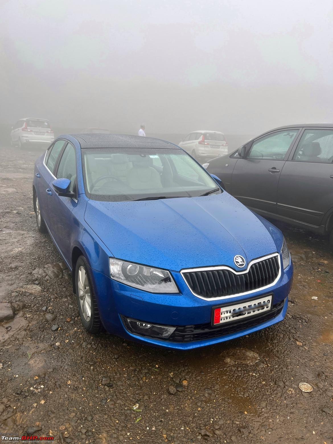

Yes, speed breakers will be easier to deal with. But the s90 is already better at tackling speed breakers than the 5 series and the Lexus ES (two other current gen competition cars that I’ve driven extensively). And you can crab walk the car over the irregular ones. Even if the car rubs its belly over a couple of humps, no big deal as the underbody protection takes care of it. However if you hit a pothole, heck even a sharp edge on an expansion joint or a road surface transfer point, your tyres may be toast and a bent rim is also a possibility. Also do factor in the waiting times for such an odd sized tyre when you need a replacement after such an incident.
Case in point:
ARTICLE: Choosing The Right Set Of Tyres for your Car-img_8478.jpeg
Here’s my Octavia happily enjoying Lonavala weather earlier today. Now I wouldn’t dare venture on this surface with rubber band tyres.

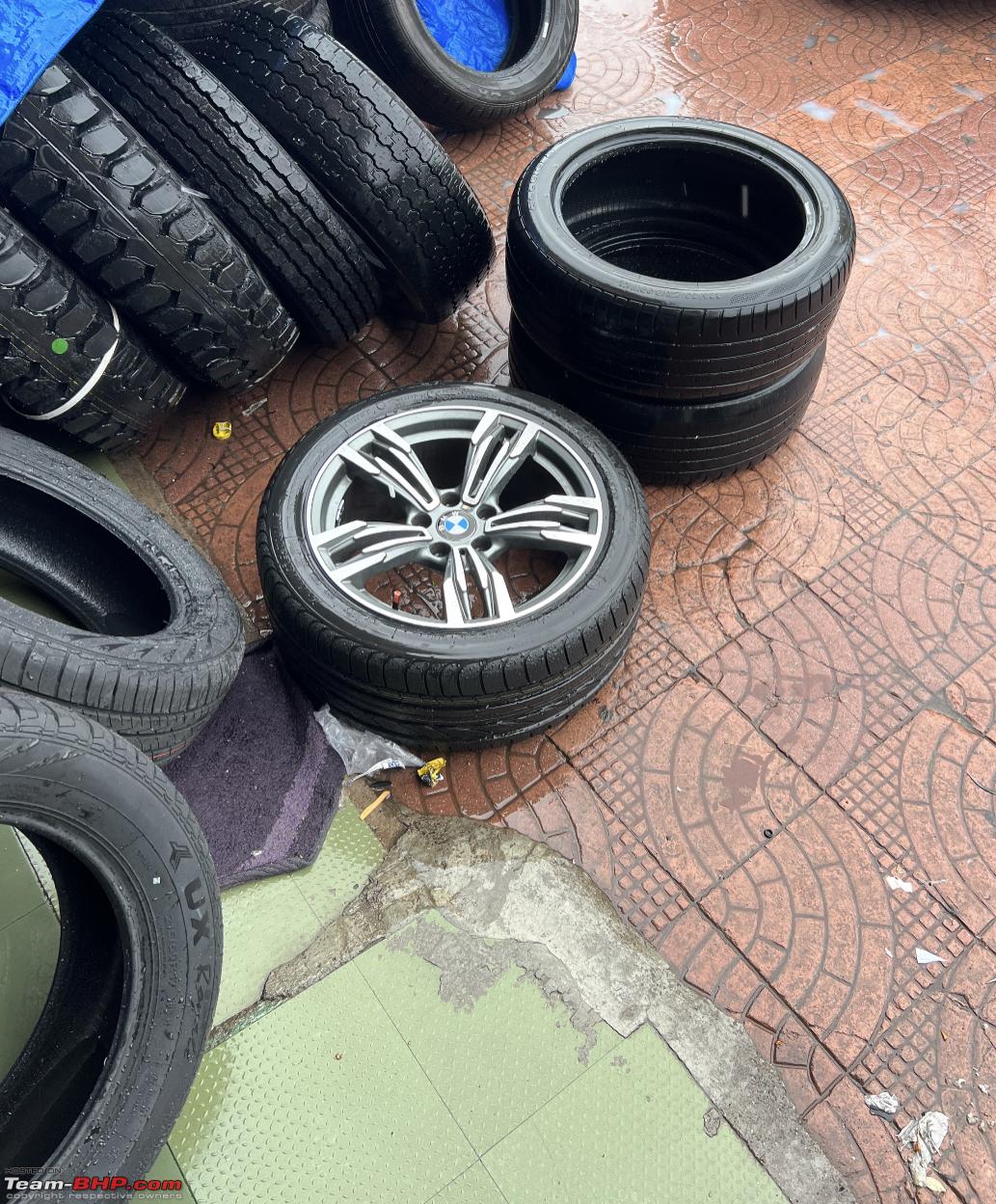

A few weeks back I hit a sharp edge in the road while driving on an unknown highway at night. It was a concrete road where nobody would expect any imperfections. And the tyre developed a sidewall bulge. This was on a 225/45/18 tyre. Can’t imagine what would’ve happened on 21 inchers.
Case in point:
Attachment 2484907
Thank you once again for your kind response. The Volvo showroom is also offering a 245 / 45 / R20 as an alternative size though it is not listed on the website. Would you recommend opting for that size instead of 245 / 35 / R21 which I am presently looking at ? This size if opted for, would raise the ground clearance by 26mm taking it to 177mm. Sidewall height is also similar to stock tyres which are 245 / 45 / R18.
There is one more option - 235 / 50 / R19. Additional ground clearance gained is 20mm i.e overall 172mm.

Would you advise opting for RIM protectors like Alloygator with low profile tyres and 21s. Would that help ? Have you used any of those ? Thank you.
